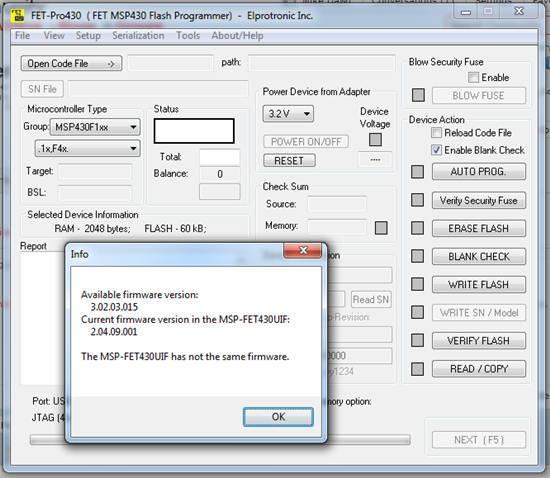

  • Hi Lisa,
    OK, I download the free software "FET-Pro430" and install into my PC. I run the "FET-Pro430" and read the JTAG firmware.
    Do you think I have the correct firmware in the JTAG for the CCSv4.2?
    The JTAG firmware is

    Give that a try.  You can tell if you are v3 dll (won't work in CCSv4) by the device manager.  The v3 dll shows up as a CDC device + Msp430 virtual com port, the dll v2 shows up as an HID device + msp430 virtual com port.
    As long as you have the v2 dll loaded you should be fine in CCSv4.

  • Hi Lisa,
    This is not working. I am still getting
    Error connecting to the target:
    Could not find device (or device not supported)
    Maybe I should uninstall TI CCSV4, and re-install it again to see if it work?
