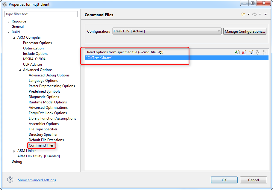

I'm building my project with either the full CCS environment (my development environment) or with the command line scripts (like explained on http://processors.wiki.ti.com/index.php/Projects_-_Command_Line_Build/Create --> that's my build machine environment)
  • In order to use a single project file for both environments, I simply import the existing project file during my headless build, with the com.ti.ccstudio.apps.projectImport command and then build it with projectBuild.
  • But now I would like to be able to distinguish between development builds (done in CCS) and my automated command line builds: I would like to define the pre-defined macro AUTOMATED_BUILD for the command line build.
  • In order to make sure the developper using CCS always use the correct configuration (without the AUTOMATED_BUILD variable), I also want to limit me to a single configuration in this project.
So the question is: is there a way, during the import or the build done with the command line scripts, to automatically define my extra pre-defined macro?
The only option I found until now is  -ccs.defineBuildVariable, but only usable with com.ti.ccstudio.apps.projectCreate, not with projectImport or projectBuild.
Thanks for your help or suggestions.

    One of the main purposes of supporting multiple build configurations is for use cases as yours where you wish to easily maintain build options. But I understand you wish to avoid this so:
    Not by default with the command line build utility. If you want to add a preprocessor define variable outside the CCS environment before you build, you can try modifying the .*project files directly or define it in an options file that get included in the build. The options file is basically a text file which has additional build options. You can manually add/remove "--define=AUTOMATED_BUILD". This method is probably easier to deal with.

  • Thanks for the suggestion, the external option file might be the solution that answer my needs.
  • Could you explain what is an 'options file' and how to use it in CCS?
    Thank you,
    Piotr
  • The options (or command) file is basically a text file which has additional build options that is read by the compiler. The file is passed to the compiler via the flag:
    --cmd_file=filename
    For more information, see Section 2.3.2 of the Compiler User's Guide:
    http://downloads.ti.com/docs/esd/SPNU151/index.html
    To use it in CCS, use the field in the project properties as shown below:
