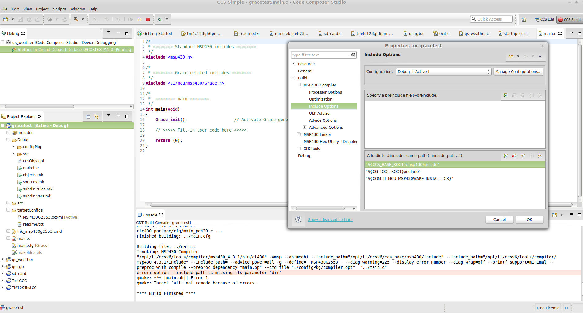

     error: option --include_path is missing its parameter 'dir'
    Invoking: MSP430 Compiler
    "/opt/ti/ccsv6/tools/compiler/msp430_4.3.1/bin/cl430" -vmsp --abi=eabi --include_path="/opt/ti/ccsv6/ccs_base/msp430/include" --include_path="/opt/ti/ccsv6/tools/compiler/msp430_4.3.1/include" --include_path= --advice:power=all -g --define=__MSP430G2553__ --diag_warning=225 --display_error_number --diag_wrap=off --printf_support=minimal --preproc_with_compile --preproc_dependency="main.pp" --cmd_file="./configPkg/compiler.opt"  "../main.c"
    Can be of help project? I just loaded GRACE set some peripheral and launched compile.

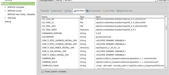

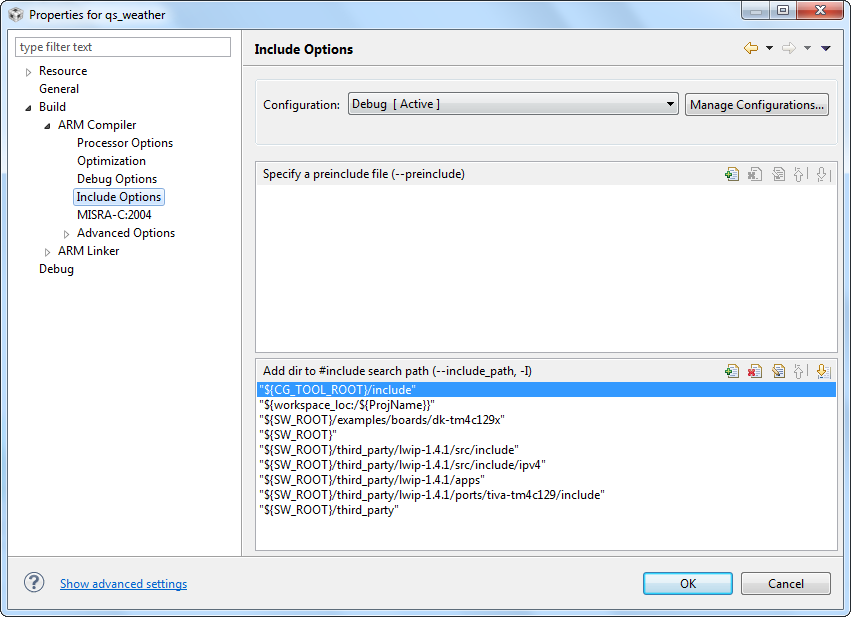

  • Lets see if we can get through the build issue.
    It is the include paths causing the problem.  I see 3 --include_path= statements on the command line but the last one is blank which is causing the error.
    I used to see that a lot when there was a macro in the include path but that macro was undefined resulting in a blank string being inserted for the path.  However you mentioned parenthesis (). Can you send me a screen shot of your include options settings?  I suspect that this may be related to Grace as the Grace for v6 is not yet available.  Was supposed to be out this week.
     Hi Johns, proud to do so, I also include full project files too.
    4667.gracetest.zip

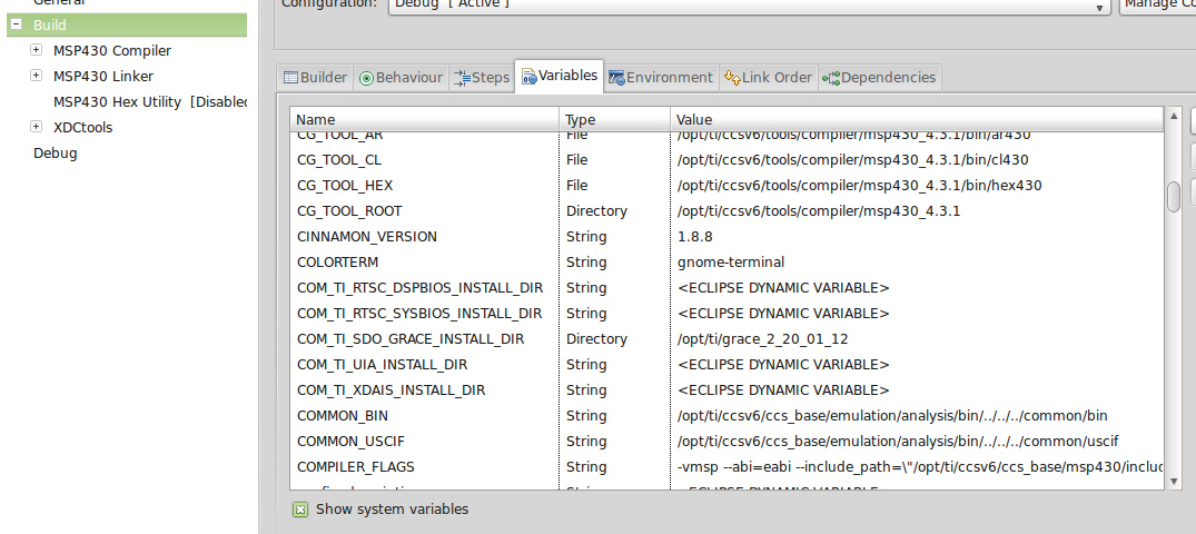

  •  I forgot comment on your snapshot of include dialog, I posted MSP430 include, on your image is QS-weather mine is identical to your and work fine.

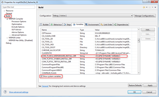

  • the problem is that ${COM_TI_MCU_MSP430WARE_INSTALL_DIR}
    I bet that is not defined.  Can you go into your options again and look at the system variables and see if it is defined.
  •  You won the game, where I can meet you to pay for ;)
     After adding that var project build and link, can't load to due I don't own a working FETUSB adaptor so launchpad, Olimex and Elprotronics still are all Linux unsupported.
