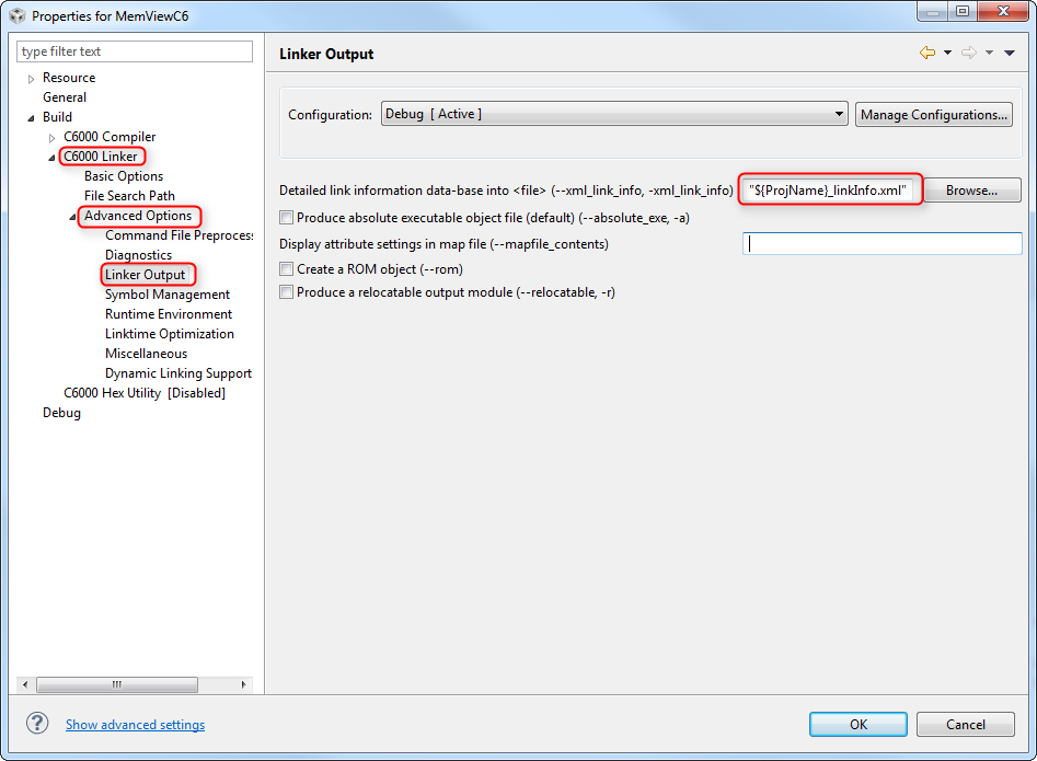

    What do your build options look like?  The memory allocation view will be looking for a specific naming format.
    For me my project is called MemViewC6 and this is the option that is generated by default.
    --xml_link_info="MemViewC6_linkInfo.xml"
    For you on the project that doesn't work what does the filename look like?
    When creating a new project CCS sets that option using a macro that contains the project name:
    How are you handling the 32 outputs, are they separate project configurations?
    I agree that being able to load a file would be useful, especially if you could load multiple and compare side by side.  I filed an entry to track that request (SDSCM00050906).
