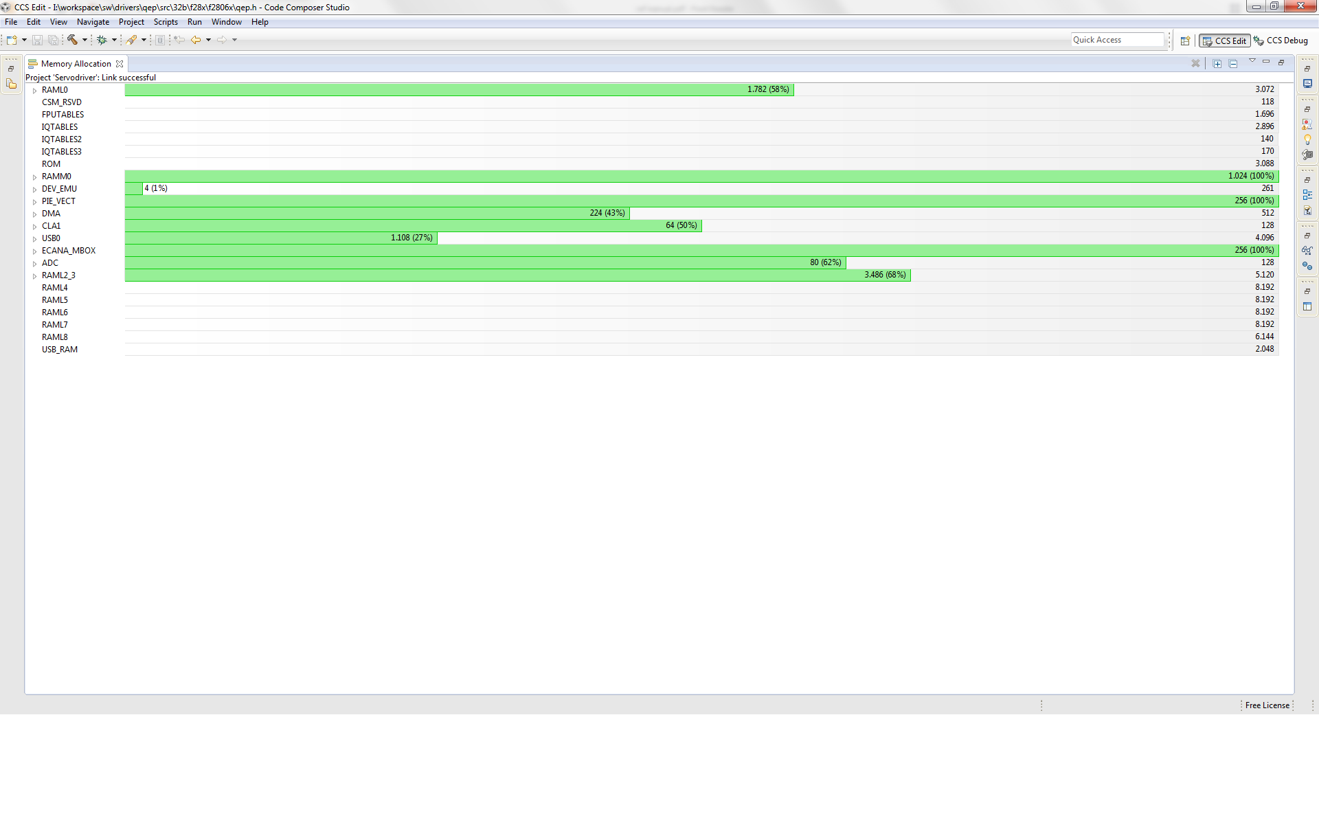

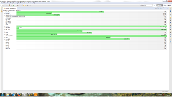

  • To make it complete the memory watch window:

    Yes I  rebuild my application.
    Looks like the view is not updating correctly. Can you close and re-open the view? If that doesn't help, did you try restarting the debug session?

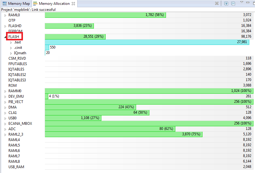

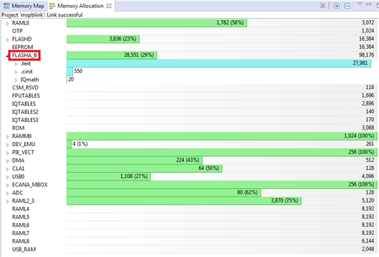

  • Strange... I loaded those xml files and see both FLASH and FLASHA_B
    FLASH:
    FLASHA_B:
    Something is off in your environment... can you try using a new clean workspace folder?
