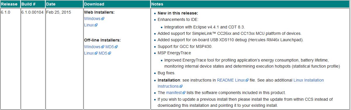

I realize there's a lot of bug fixes in CCSv6.1, as shown in the release notes.
However, are there any significant changes in CCSv6.1 that affect all CCS users, i.e. C2000, C6000,linux, windows and etc?
Has CCSv6.1 taken advantages of any of the improvements in eclipse kepler (4.4.1)?  It doesn't seem to use eclipse's split window feature.

    Here are the changes:
    Source:
    Gautam
  • Ok, that answers part of my question.
    What type of new features do I get with the integration with 4.4.1 and CDT 8.3.  At least one of 4.4.1 features is not working in CCSv6.1.
  • Hi Stephen,
     We should inherit many of the features in kepler. The split window feature is in CCSv6.1
