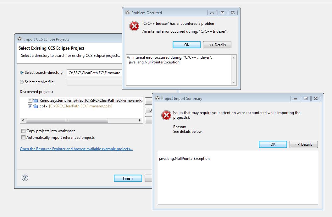

Problem: When I attempt to import an existing project (created in CCS 5) to my current workspace (Recently Updated CCS 5.5) I get the following error:
An internal error occurred during: "C/C++ Indexer". java.lang.NullPointerException

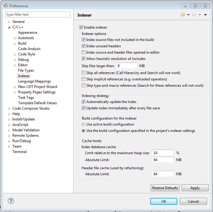

I am attaching screenshots of the error as it occurs, as well as my indexer settings. I have a zip file of my install_logs directory, but I am not exactly sure how to attach it to this post.

  • Hi Carl,
    The .cproject metadata file, in the root of your project, seems to be slightly corrupted.  It is possible that this file has been manually edited at some point.  It is missing the <builder>/"parallelizationNumber" attribute in several places, and sets that same attribute to an invalid value (-1) in one place.  I have corrected the .cproject file, and i'm attaching it here (I had to rename the file to cproject.txt to bypass the upload filter).  I've set "parallelizationNumber" to "optimal".  That allows the project to be imported into CCS v5.5.0.
    - Baltasar
    cproject.txt
  • This did the trick. Thank you Baltasar and everyone else involved for all of your help!
