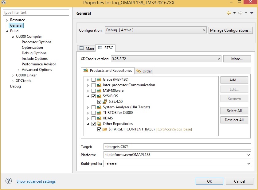

Here is my configuration:
- CCS v5.5,
- OMAP-L138 (Avanet Spartan-6/OMAP-L138 Co-Processing Development Kit),
- Blackhawk XDS560v2-USB,
- SYS/BIOS 6.35.4.50,
- xdcstools 3.35.3.72.
I created the project Example Log from the example project (SYS/BIOS->C6000->OMAP-L1x->EVMOMAPL138->Generic examples->Log Example). I used the default OMAPL138.ccxml.
Unfortunately I can't edit platform : Tools -> RSC Tools -> Platform -> Edit/View. I have choosen Package Name and CPU Core:
but when I'm pushing Next button nothing happens. Program doesn't go to page 2/2. I can't change memory allocation.
Does anyone have similar or the same problem and know solution?
Thank you.
Lukasz.
    I don't see this issue, so I wonder if it may be specific to your PC or OS.
    With the same project imported into CCS 5.5, I am able to get to the page where I can edit the platform, when I click on Next.
    Problem solved. I had under CCS 5.5 xdctools_3_30_01_25_core installed. I've changed folder name and CCS doesn't see xdctools_3_30_01_25_core.
    Finally I can edit platform.
