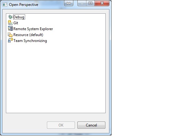

    Screen shot for Opening Perspective...  I am looking for what you said the "Edit Perspective".  Is it the same as "Resource" Perspective?

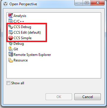

  • Louis - something looks very wrong with your environment. First of all, you are in the 'Resource' perspective, which is not one of the default CCS perspectives. Second, the CCS Edit, CCS Debug, CCS Simple perspectives are missing:
    It seems like you are missing some components in your install. How did you install CCSv6.1? and how are you launching it?

  • No, it sounds like everything you are doing is fine. Unfortunately it sounds like your installation may have gotten corrupted when you updated to 6.1.1. My apologies for that. I think it is best to simply reinstall CCSv6.1.1 from scratch into a clean new directory.
    ki
  • I got that working after a fresh installation. Thanks Ki for your help.
