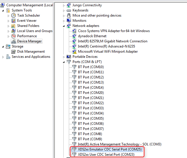

  • Hiroyasu,
    Does the xds200 show up in device manager?
    John
  • HI, JohnS
    XDS200 show in Device manager
     XDS2xx Emulator CDC Serial Port(COM3)
     XDS2xx User CDC Serial Port(COM4)
    I guess this is not probrem.
    Best Regards
    Hiroyasu
  • Hiroyasu-san,
    We are really struggling to figure out what is going on.  With the COM ports showing up properly in Device Manager we would really expect the conf utility.
    One of our guys noticed that the COM port numbers low.  Is this on a virtual machine?
    Another thing to check is are these USB3.0 ports?  If so could you try a USB2.0 port.
    John

  • Hi, John
    Thank you for your reply.
    We used virtual machine.
    It work when PC is changed.
