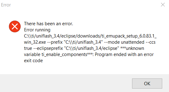

When I try to install Uniflash (uniflash_setup_3.4.1.00012) with mode as win32 (requires user intervention for installation)the installation works. But if I try the same installation with mode as unattended (without user intervention )the installation fails. Any idea why this happens?. Thanks in advance
Girish Ramaiah said:But if I try the same installation with mode as unattended (without user intervention )the installation fails.
Could you provide more specifics on how the installation fails, and the exact command line used to invoke the installation?
And which operating system are you using?
I use Windows 10 OS. The installation fails after sometime, the first error pops up and then in a while the second error message comes up.. I was looking at the installation directory and I saw uniflash folder was created and once this error came up the folder was deleted.
Installation command:
uniflash_setup_3.4.1.00012.exe --disable-components connectivity,simplelink_cc1xxx_cc2xxx,simplelink_wifi,c2000_jtag,c2000_serial,msp430,msp432,stellaris,stellaris_alt,processor,sitara,debugserver,ucd_digital,ucd31xx_device_support --enable-components hercules --bh_install 1 --mode unattended
Could you please look for a bitrock*.log file, generated from the unattended install, in %TEMP% and attach it here?
Danish
Hi Girish,
I'm sorry, there seems to be a bug in the "unattended mode" and there doesn't seem to be a workaround. It should be fixed in the next version.
