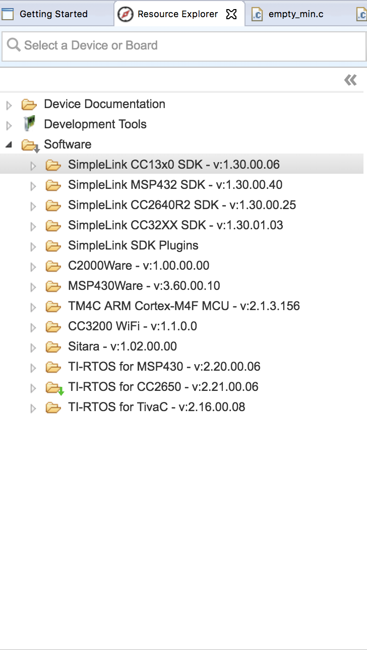

I got error importing example project on MacOS: Location can't be resolved.
In Windows version this function works fine.

    But directory "CC26xx Bluetooth Smart... " with ProjectZero is disappeared
