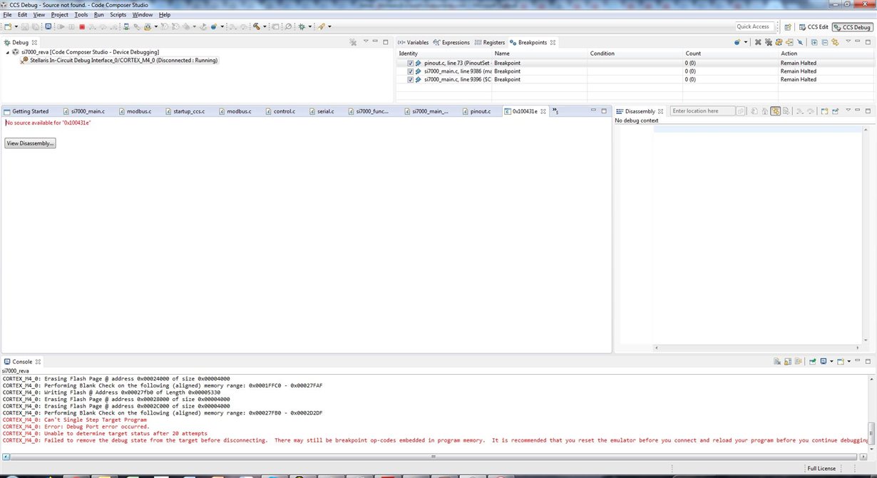

CCS/TM4C1297NCZAD: Debugger goes away when I execute this code. Can't Run Target CPU; Error; Unable to determine target status after 20 attempts.
Part Number: TM4C1297NCZAD

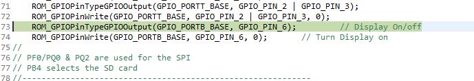

I almost have my development environment set up with Code Composer 6.2.0.00050 and the TM4C129X Development Board connected to our controller board.  I am able to build the code and download it to the target without any problems (as far as I am aware).  I have hooked up a DC power supply to run our board (instead of a noisy switching power supply).

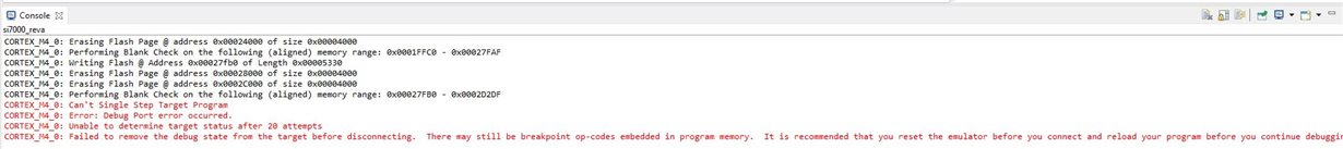

Before I was getting these messages:
CORTEX_M4_0: Error: Debug Port error occurred
CORTEX_M4_0: Trouble Halting Target CPU
The first fix was to locate a file on my hard drive where source code is (not our source code), since I imported this project from someone else's computer who had a different file directory structure.

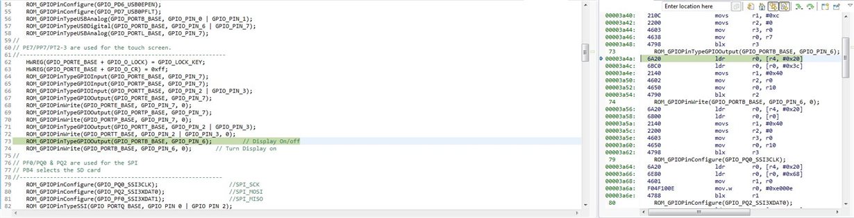

Now I am able step along for some distance until I get to the code in the first screen shot.  Once I press F5 again, it goes away, and I no longer have any control of the debugger.
Any ideas?

    Instead of running, can you continue to single step past that instruction?

  • I thought I was already single stepping, but I was able to refine it a little more.  F5 is "Step Into", and that's what I was using.  Now I have tried Ctrl+Shift+F5 (Assembly Step Into), and I was able to go farther, quite a bit farther.  I branched into some other code I don't have source for, and in the screen shot below, the next instruction in Assembly causes me to lose control of the debugger.
  • Just to be clear, after that it runs our program. Our instrument becomes completely functional, but I can no longer debug.
  • Sorry, yes I was asking about asm step into.
    Can you show me a screenshot of your debug view when you step past that last asm instruction? Actually you can provide a screenshot of your entire CCS IDE.
    ki
  • Okay, here are a couple screen shots.  Hopefully this helps.
  • Is it possible that there is anything wrong with configuration on my laptop, or the actual installation? I would think it's not likely, since it's so repeatable on where it goes away. Someone else in the company is able to run the debugger with the same code and watch variables changing while the program is executing.
  • For some reason, the debugger loses debug connectivity to the target at that point. This causes the debugger to disconnect from the target. Hence you lose debug visibility. Have you tried reconnecting? I have a feeling that will not work due to the original debug connectivity issue that forced the disconnect in the first place. But curious what would happen.
    You mentioned that a colleague is able to run the the same code and debug past the point you lose connectivity. Are they using the same target board you are? If not, can you have them try the same exact HW on their PC?
    ki
  • That's right, I am not able to connect again. The only thing I can do is use the red square to stop the debugger interface. My colleague has not tried to help me with this issue yet, but I have used his exact hardware on my system, and I still see the problem on my system, while he does not see it on his.
  • Interesting. Can you reproduce the issue with debug server logging enabled? Attach the generated log to this thread:

  • Is there any issue with register R0 & R3 values, as compared with the linker command file memory limits?
    Is it possible that my build is faulty?  The difference between my machine (not working) with 2 other coworkers' machines (working) is that I am building on my machine, and they are building on theirs.  I have tried their hardware on mine, etc.
    Based upon the addresses, the program is trying to write to the GPIO Direction (GPIODIR) register of GPIO Port B.
    Given that the source statement on which the problem occurs is ROM_GPIOPinTypeGPIOOutput (GPIO_PORTB_BASE, GPIO_PIN_6); the addresses are expected.

    The write to Port B, pin 6 is where it fails on my system, and this is the instruction to turn on the touch screen LCD display on our system
    The error always occurs at exactly the same instruction.
    The debugger steps through many instructions to get to that point without any issue.
    Could it be there is not enough power to run the display? Could that cause an issue with the JTAG pins? We believe power to the board is more than adequate.

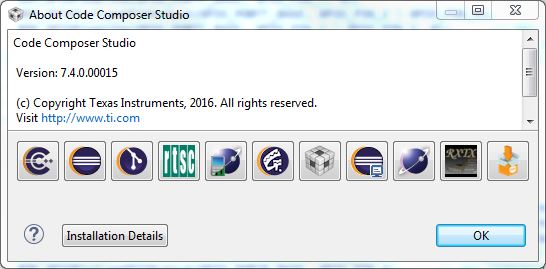

    May I ask you to try two more things? The first is update to the latest CCS version (7.4). If that fails to help, please also take the *.ccxml file from your colleague and use that file to launch the debugger, instead of the one you created.

  • I am already using 7.4 now, and last night I did an update to make sure I had the latest of everything.

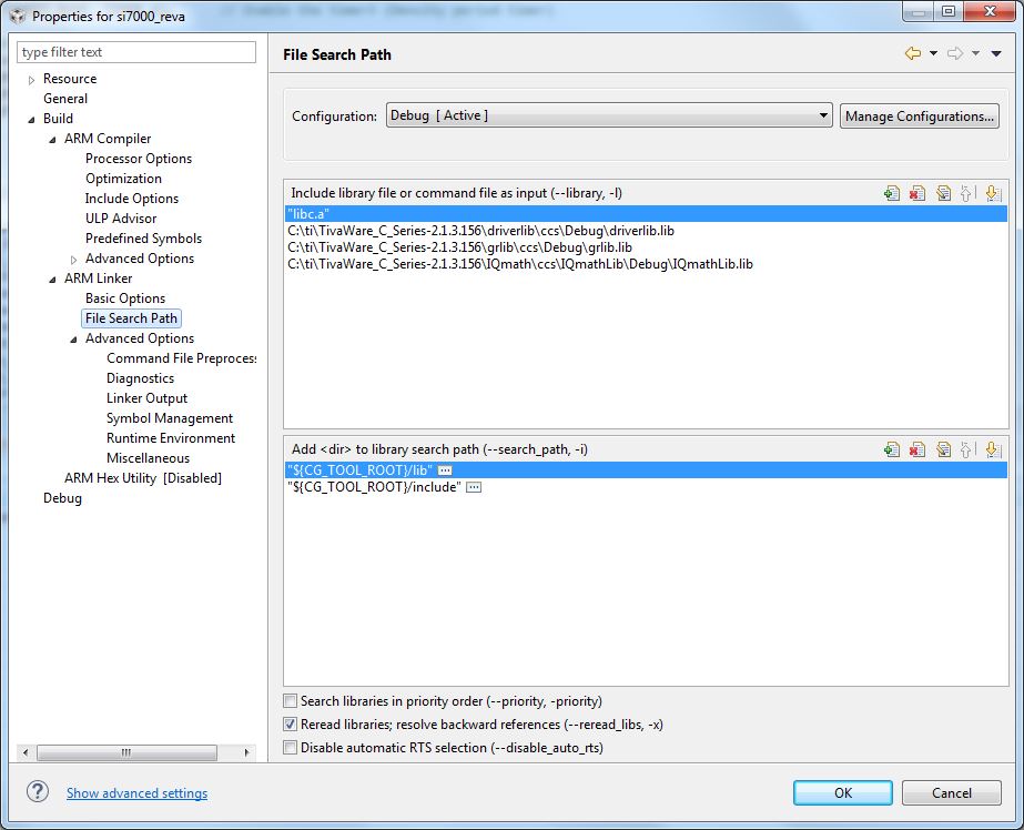

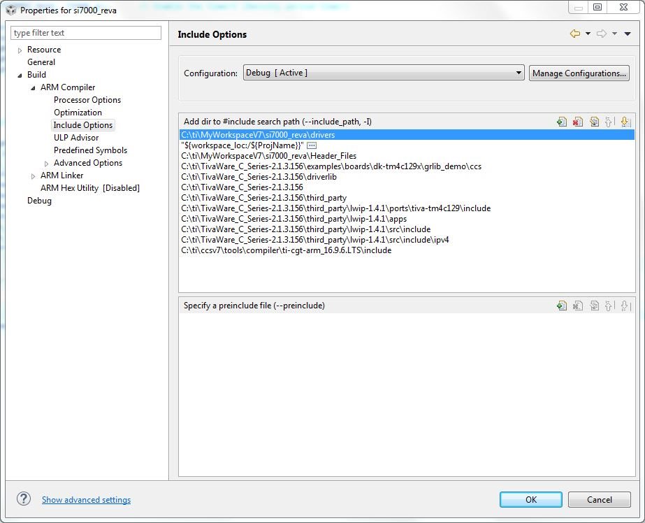

    We have not talked about project properties, like include files and ARM Linker options.  My settings look different from at least this colleague's settings.  Is it possible something there is causing an issue?
  • I have a big mixture of includes from two different Tivaware versions.  Could that be causing a problem?  Some things are pointing to
    TivaWare_C_Series-2.1.3.156
    And some are pointing to
    TivaWare_C_Series-2.0
