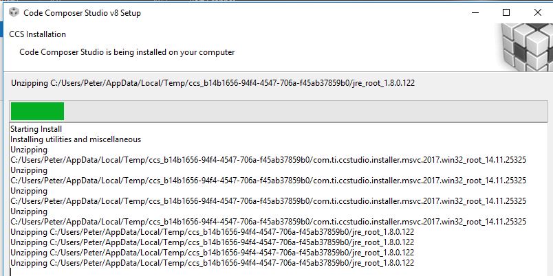

Hi Peter,
For some reason, 7z is unable to extract the files it needs - doesn't give a useful error message. Could you please try the following:
Move the offline installer package CCS8.0.0.00016_win32 to C:/Users/Peter/Documents/Courses/.

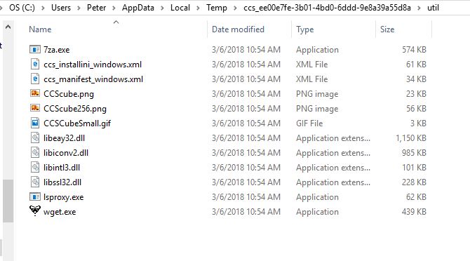

Start a command prompt as administrator and run the following:
C:/Users/Peter/Documents/Courses/CCS8.0.0.00016_win32/ccs_setup_8.0.0.00016.exe --test true
This will leave the temporary folder so we can check to see if the files are getting extracted, or are not available, as it says in the logs.

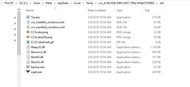

I was unable to zip the entire file so I zipped the files in parts. The eclipse/download directory has a transfer error so it is not included. I also included some files from the Temp directorybitrock_installer_16264.zip4520.bitrock_installer.zip
Hi Peter,

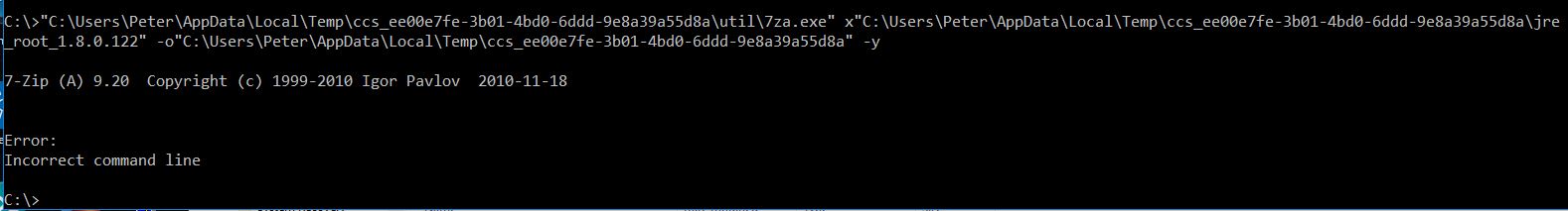

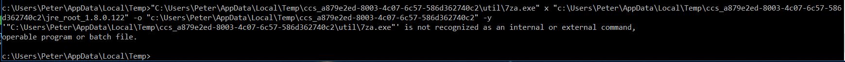

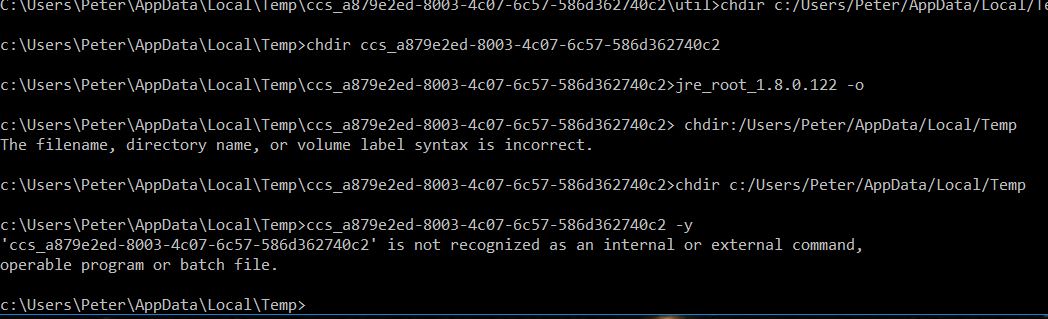

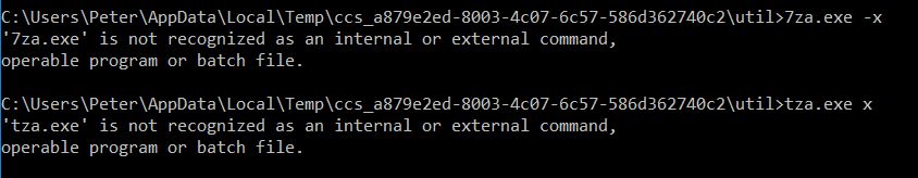

Could you see if you can run the command:

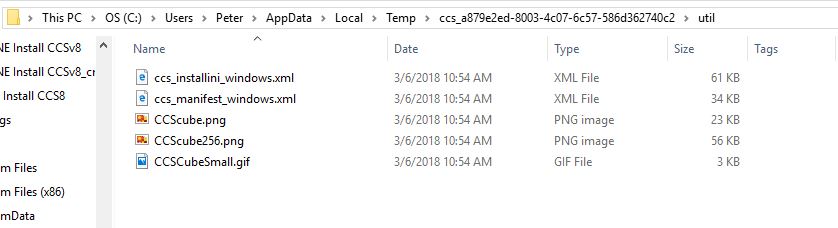

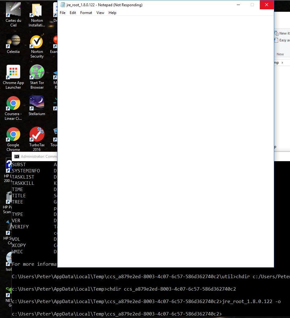

"C:/Users/Peter/AppData/Local/Temp/ccs_a879e2ed-8003-4c07-6c57-586d362740c2/util/7za.exe" x "C:/Users/Peter/AppData/Local/Temp/ccs_a879e2ed-8003-4c07-6c57-586d362740c2/jre_root_1.8.0.122" -o"C:/Users/Peter/AppData/Local/Temp/ccs_a879e2ed-8003-4c07-6c57-586d362740c2" -y

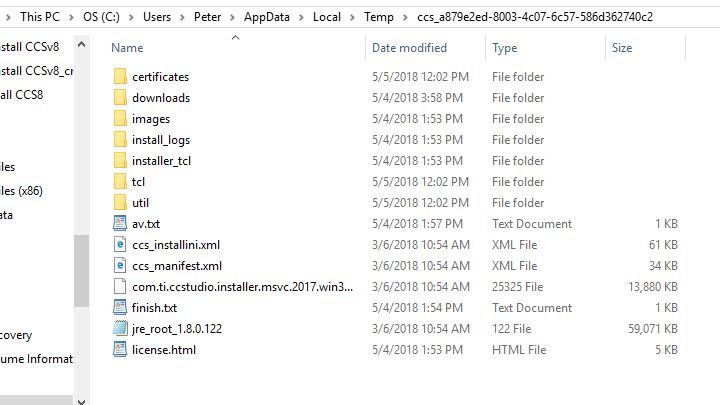

What's the size of "C:/Users/Peter/AppData/Local/Temp/ccs_a879e2ed-8003-4c07-6c57-586d362740c2/jre_root_1.8.0.122"?
Does it extract a zip file?
Danish

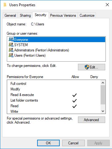

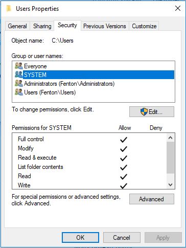

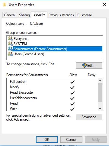

I am not aware if there is something else running in background that would filter these files. I am running the install as admin so that should take care of any directory permission issues.. one would think.
I noticed though that Users directory permission are a little strange where Everyone category is restricted, all other directories in path have no restrictions on permissions :take a look at the attached:

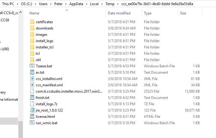

here is the directory with the .bat file:
and the contents of the file:
I will run this file shortly
