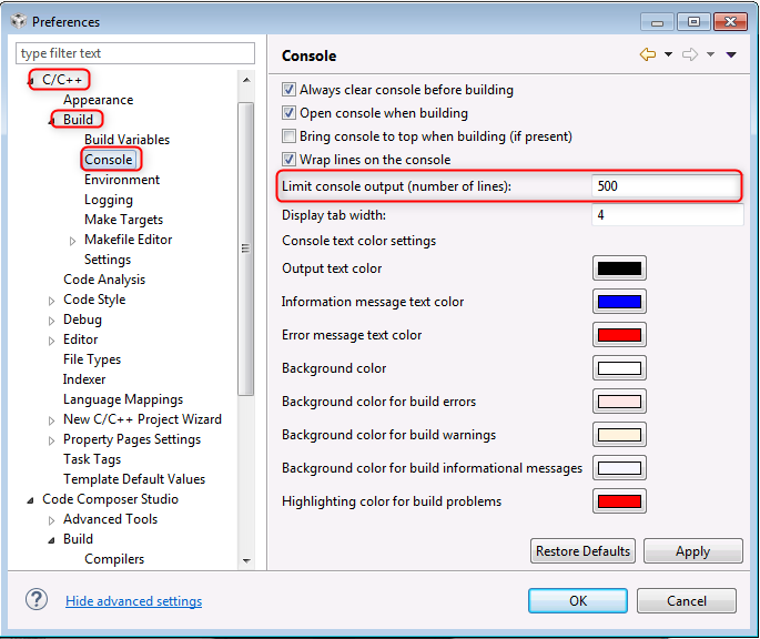

Code Composer Studio 6.1.3 is based on Eclipse and reading around I find that the Eclipse default for this window is 500 lines and that to change it I want to do Window > Preferences > Show Advanced Settings > C/C++ > Build > Console and then change the 500 to something larger.
The problem is that in my Code Composer, the Console and console lines options are not present; Build just contains 'Build scope', 'Building Project Configurations' and 'Code Analysis' controls.

  • Hi Bob,
    Below is a screenshot of the console preferences in my CCSv6.1.3 installation:
    You do not see these options?
  • Well, today I can see them bright as day but last week I literally couldn't see them, despite looking at that page twice. I searched for 'console' in the Preferences search box which gave 2 results of which this was one.  I also must have clicked through all the build options sub-pages since I remember the 'log build output to file' setting, even though you can see that when I wrote the post I hadn't noticed the '>' at the left of 'Build' that implies it has sub-pages.
