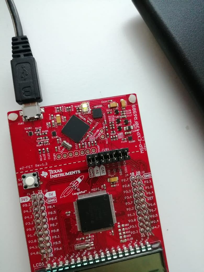

  • Hey Forat,
    Has the board worked before? Also, can you check that the jumpers on the launchpads programming header are connected correctly according to the Launchpad users guide that Tomasz linked? (Basically, that they are just populated vertically across the debug connections?)
    If that looks fine, Can you try restarting CCS and/or your PC?

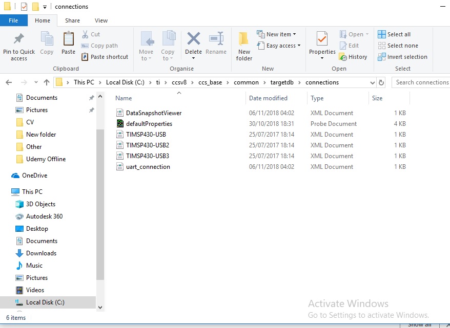

  • Hi Forat,
    could you show us content of your "connections" folder?
    In my case it is under: C:\ti\ccs830\ccsv8\ccs_base\common\targetdb\connections
  • Hi JD,
    Yes, the board was working fine, this problem is new. the jumpers on the launch pad are connected properly as you can see on the image below
    MSP-EXP430FR6989 Launch Pad
  • Tomasz Kocon said:
    Hi Forat,
    Hi Tom,
    This is the screenshot of my connection folder (C:\ti\ccsv8\ccs_base\common\targetdb\connections
  • Hey Forat,
    Any luck getting this board to work?
    Everything you've posted looks alright, so I'm leaning towards something happened to the hardware. Maybe ESD or some other event.
    If still not working, I'd recommend replacing the launchpad. If a new launchpad works, then we can assume a hardware issue.
