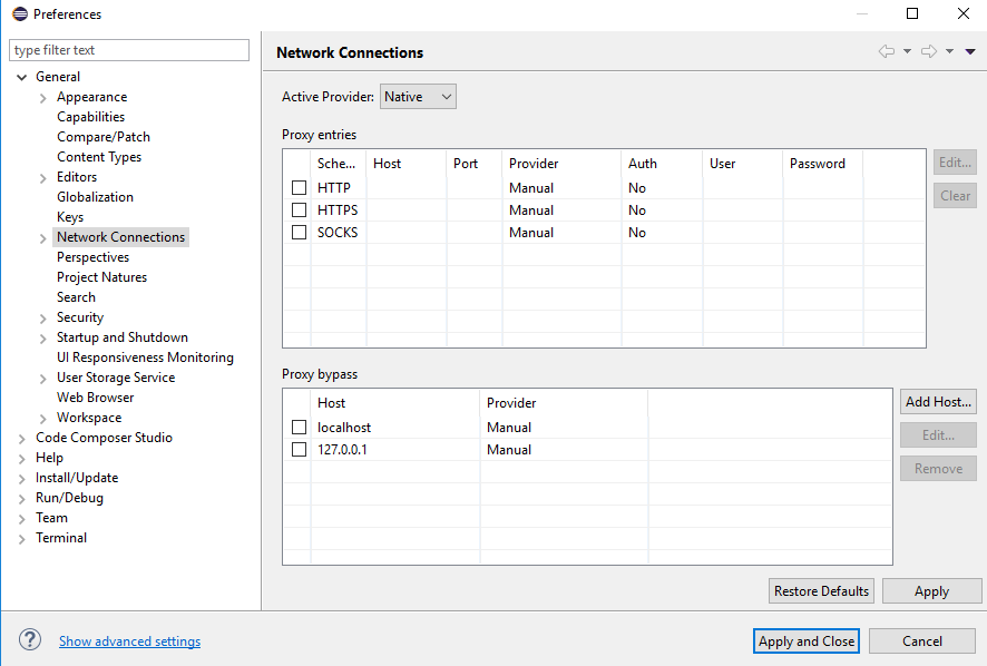

    2. Below is my Network Connections settings in eclipse (it seems to be the same for ccstudio) as they are initially set up. Does this look good to you?
  • Hi Stevan,
    Start CCS by running the ccstudio executable. In the same preference dialog, change the Active Provider to Manual in the drop list and enter your proxy setting for HTTP and HTTPS. That is if you are using proxy.
    Patrick
  • Hi Patrick,
    Ive tried that as well and still the same problem. Im confused why the proxy is being brought up by you and Ki since ive said i dont use any proxy. And the obly firewall i have is mcafee which even when i turn off ccs still cant access updates or the ccs app page.
  • Stevan,
    The issue where you cannot access updates or access the App Center page is due to that something is blocking Eclipse from accessing the internet. In some cases, the Eclipse proxy settings could be impacting things. The Getting Started page apparently uses only the system proxy setting and bypasses the Eclipse settings, which means if you can access the internet normally on your PC, then the Getting Started page should be fine. Hence why we were focusing on the Eclipse proxy settings. You mention that no proxy is being used and firewall is disabled. Are you running you machine from home and not connected to any work network?
