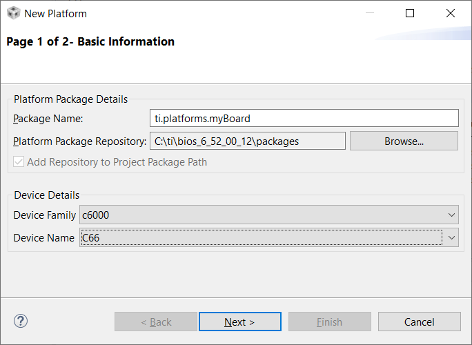

I have my own board with a Sitara AM5716 and 1GB external DDR3 RAM. I have CCS v8.3.1. The compiler generate the linker.cmd.
I would like to create the memory mapping for the DSP inside Sitara using RTSC tool but at the end I can't find it. The following are the 3 steps I follow:
1) Definition of name and device
2) Memory mapping
3) I open the project properties and try to set the new Platform but I can't find it, there are only the default platforms:

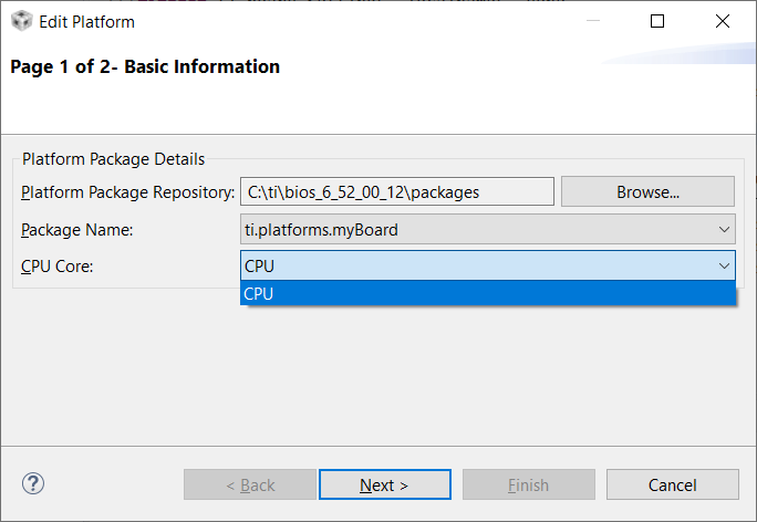

After these steps I open again the RTSC tool in order to edit myBoard file but I can see only the CPU core=CPU instead of DSP

  • Francesco,
    can you post the content of Platform.xdc from the directory 'myBoard'? I think the name 'CPU' is given to a CPU core, so try to select it and check if you can edit your previously created platform.
    When you build the platform, have you seen the message that says that your platform was successfully built? You should see a zip file ti_platforms_myBoard.zip in the directory C:/ti/bios_6_52_00_12/packages/ti/platforms/myBoard if everything went well.

    package.xdc name is correct. I tried creating it in a local directory and I added it in "Products and Repositories" without any error in the .log file but when I compile I have the following errors:
    Building file: "C:/ti/pdk_am57xx_1_0_11/packages/ti/drv/mcasp/example/idkAM571x/c66/bios/DeviceLoopback.cfg"
    Invoking: XDCtools
    "C:/ti/xdctools_3_50_03_33_core/xs" --xdcpath="C:/ti/pdk_am57xx_1_0_11/packages;C:/ti/edma3_lld_2_12_05_30C/packages;C:/ti/ipc_3_47_02_00/packages;C:/ti/uia_2_21_02_07/packages;C:/ti/bios_6_52_00_12/packages;C:/Users/Francesco/ti/packages;" xdc.tools.configuro -o configPkg -t ti.targets.elf.C66 -p myBoard -r debug -c "C:/ti/ccsv8/tools/compiler/ti-cgt-c6000_8.3.5" "C:/ti/pdk_am57xx_1_0_11/packages/ti/drv/mcasp/example/idkAM571x/c66/bios/DeviceLoopback.cfg"
    configuring DeviceLoopback.xe66 from package/cfg/DeviceLoopback_pe66.cfg ...
    The C66 device is not currently supported.
    The following devices are supported for the C66 target:
    	TMS320C6670
    	Vayu
    	TDA3XX
    	IWR16XX
    subdir_rules.mk:12: recipe for target 'build-988493487-inproc' failed
    js: "C:/ti/bios_6_52_00_12/packages/ti/sysbios/family/c64p/Settings.xs", line 194: Error: Unsupported device!

  • So, your platform is being used. That's good. You only need to change the device you are using in your platform. Delete your current platform and in its place create another one, but in the first step don't choose C66. Scroll down more, and find TMS320C6670. Then, you can customize your platform in the next step to fit what you actually have on AM5716. The choice of the device matters for cache settings and interrupts, and as far as I can tell, for these purposes SYS/BIOS treats all 66 devices as if they are TMS320C6670.
  • Sasha,
    I created a new project with sysbios and a new platform using TMS320C6670 as you suggested: CCS compiled the project.
    For the project MCASP_DeviceLoopback_idkAM571x_c66ExampleProject (TI example) I had to create a platform with DRA7XX,, then it compiled the project.
    Thanks for your precious help!
