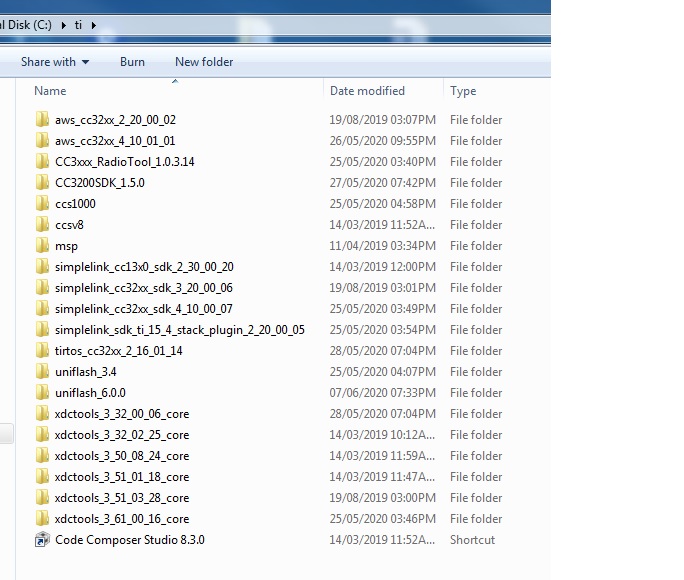

    I intentionally separate the workspace, one for CC3200SDK and another for Simplelink_cc32xx_sdk_4_10_00_07.
    In my case, I can uninstall  Simplelink_cc32xx_sdk_4_10_00_07, CC3200SDK  and  tirtos_cc32xx_2_16_01_14.
    Is there any requirement for the installation sequency?
    Here is the content in my Ti directory.
    Sam
    No there is no such requirement.
    We would still need additional details in order to understand the reason for your build error. With your current installation set up, you are saying that the examples from CC3200_SDK build OK but the ones from Simplelink_cc32xx_sdk_4_10_00_07 do not. Is that correct?
    As requested earlier, could you please save the complete build logs (as described here) of a project build from CC3200 SDK and a build from SimpleLink CC32xx SDK and attach them both here for us to review?
