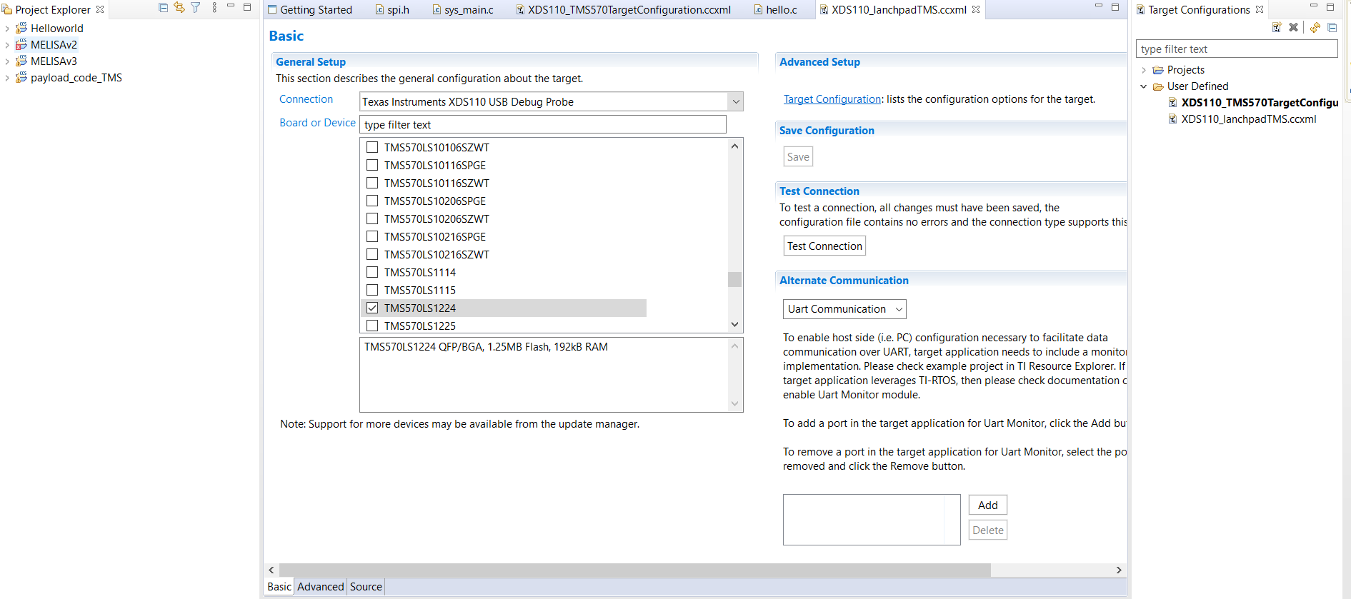

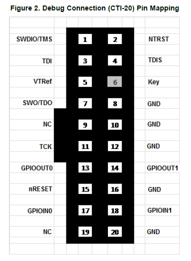

Hello, I am trying to charge a code into a uC TMS570LS0714 using JTAG connection through XDS110 debug probe. I am using the CTI-20 pins connectors as shown in the figure.  I show you the configuration I am using as well in the figures. The pinout configuration is the following one:
uC pin                  XDS CTI-20 pin
TMS-108             SWDIO/TMS-1
nTRST-109          NTRST-2
TDI-110               TDI-3
TDO-111             SWO/TDO-7
TCK-112              TCK-11
RTCK-113            NONE
3.3 V                    VTRef-5
GND                     GND-10

    trying to charge a hello world code with the target configuration as shown in figure above, using the debugger into the lanchpad wich should be the same XDS110 and I have exactly the same problem doing the test connection and the debug. Could it be a software problem? maybe version of CCS? I am using the last 10.1.1.

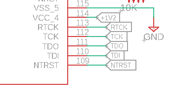

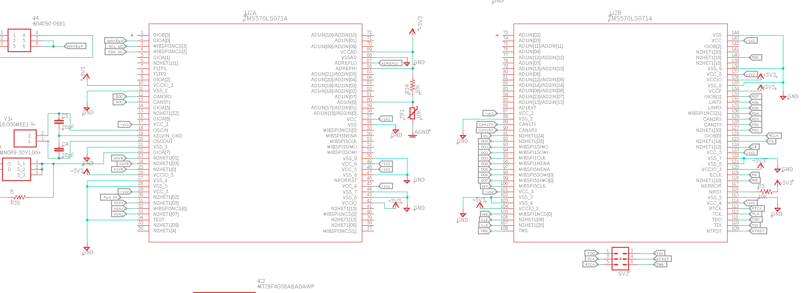

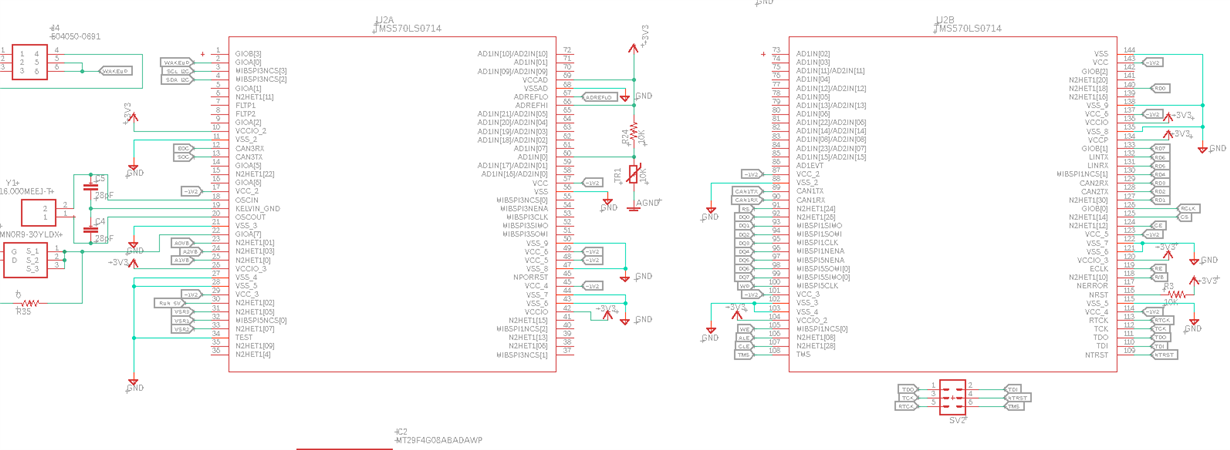

  • The error seems to be a power supply problem, but I checked the datasheet and the layout and it seems to be right, can you confirm me that? Here is the image of the layout:

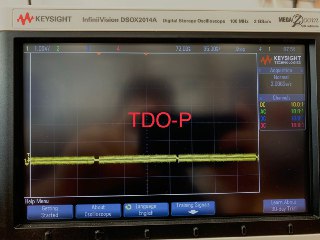

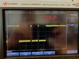

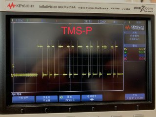

  • Thi is what I see on TDO with the oscilloscope:
    Please share the GND between JTAG emulator and your board. The JTAG emulator needs to know the power supply (VTref, 3.3V) on your board.

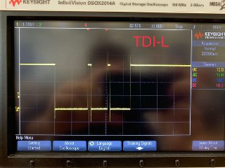

  • Hello, I did but I have the same problem. In addition I have a launchpad with the same XDS110 debugger and a uC of the same family. The launchpad works correctly and I am comparing the test connection of the debug in both cases. The signal on the PCB are a bit dirty but the big difference is on the TDO. I show you the images below. The images ended in L are the Launchpad signals, the images ended in P are the PCB signals:

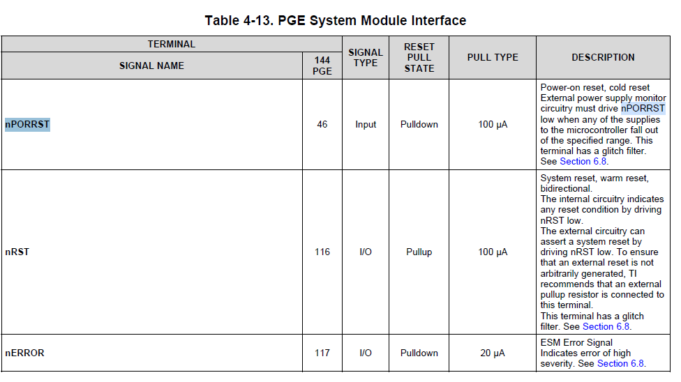

  • There is no response from TMS570. The MCU may be in reset state.
  • Just checked your schematics. Your device is in RESET.
    The nPORRST (power on reset, pin 46) pin should be externally pulled-up. You should not leave this signal floating.
  • Oh, I didn't see it. So it should be pulled up to 3.3V or it could be pulled up to 1.2V? It is because I have a 1.2V signal on one side of this pin. Which resistor do you recommend me to use for this pull up? Can I connect this pin directly to the voltage without resisotr? In the datasheet as shown in table I can't see any resistor value.
  • nPORRST has to be pulled up to 3.3V (VCCIO).
    2.2kohms is good enough.
    Please refer to the nPORRST Electrical and Timing Requirements in datasheet (Table 6-4).
  • Everything is working correctly now, thank you so much.
