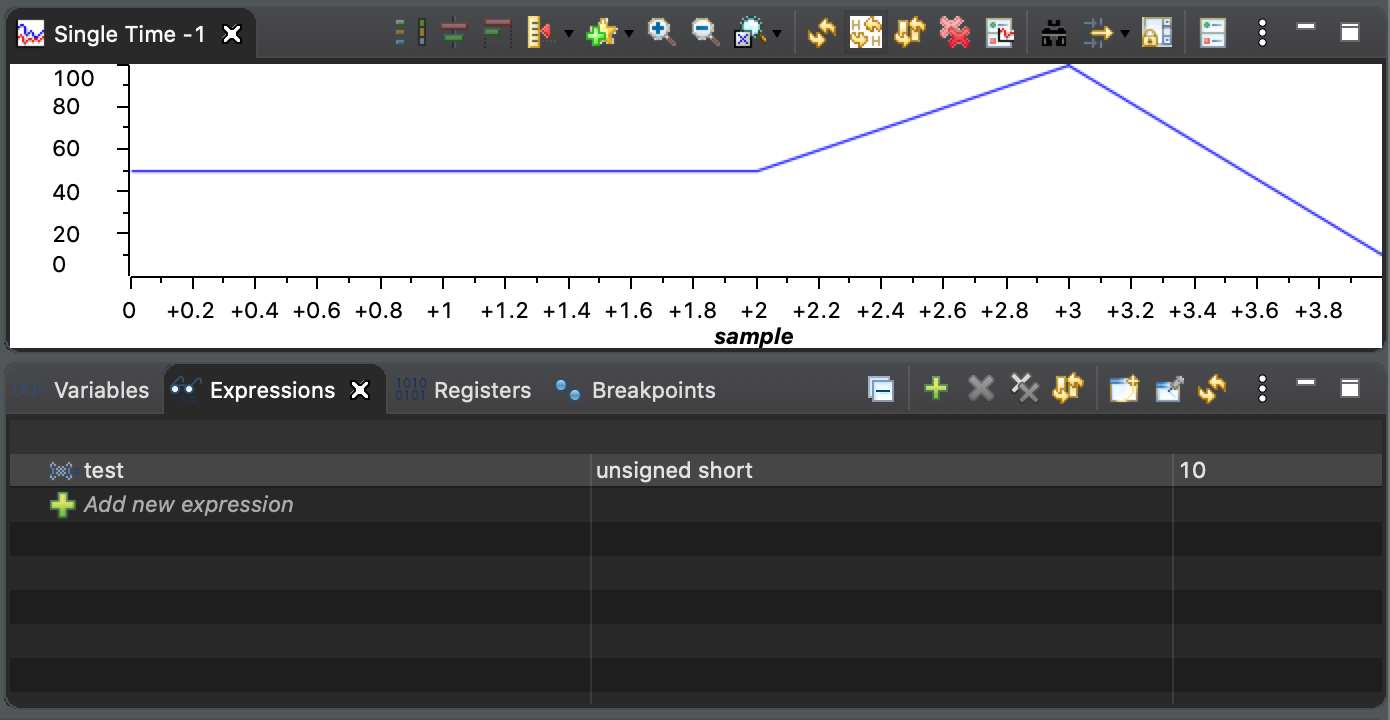

  • Hi John,
    I have tried what you said, but as you see from my screenshot the value in the graph does not get updated according to the value in the watch expression tab, so what could be the problem here?
    Tassneem
  • If you click the refresh button manually when halted does it show the value?
    For example if I have my variable in the expressions view.  Change the value and click refresh in the graph it will update with the value.  Here I entered 50, refresh, 100, refresh, 10, refresh
    I just want to see if the graph is connected to the variable ok.

  • Hi Tassneem,
    Can you try closing the graph and reconfiguring/reopening it? I find the graph functionality to be a little flakey sometimes and reopening the graph often does the trick
    ki
  • Yeah, the continuous refresh button was clicked. I closed the graph and reopened it and somehow it finally worked. Thank you so much fro your help and support!
