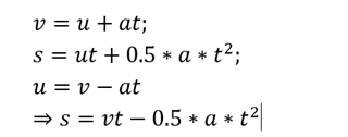

3-  The logic to convert acceleration to angular distance is implemented this way:
SensorlessTrapController.AccelVelocityInit +=
                    SensorlessTrapController.AccelRate; //increase velocity by the acceleration rate
            SensorlessTrapController.AccelDistance +=
                    (SensorlessTrapController.AccelVelocityInit
                            - (SensorlessTrapController.AccelRate >> 1)) >> 3; //calculate distance
What is the physics based derivation for this logic?
Also, in the above code, when SensorlessTrapController.AccelDistance hits the value 20834, it means it's travelled 60 degrees. How is 20834 derived?

  • Hi Adana,
    Sorry for late.
    For this code, the electrical angle of the motor is calculated in an open loop. His physical formula derivation is the calculation formula of speed and distance. We set his acceleration to 80Hz/s. The acceleration is related to the 60° electrical angle. The faster the acceleration, the faster the commutation in the open loop. The same 60° is obtained through conversion, and it determines the commutation speed in open loop together with the acceleration。
    Jenson
  • Hello, thank you for your response. But we're looking for some more elaboration. In particular, we're looking to control our motor for a specific application using MSP430FR2355 and we need to modify this code to change the PWM period, acceleration rate etc. depending on our application. We're trying to understand how to calculate these constants (like ACCEL_60_DEGREES for instance). Would you be able to share the physics based formula, or the relation of acceleration rate to 60 degrees angle or the conversion etc?
  • Hi Vinay,
    The calculation formula is based on :
    Convert it to an angle, because 60°=pi/3, the angle value can be obtained according to the calculation
    By the way, what company are you, I think the sales team of TI can give you a certain amount of support, so that you can carry out research and development quickly
    Jenson
  • Thank you, Jenson! This helps!
    I think someone from my Org is already in touch with TI sales and I think they mentioned that this forum would be the route to get the fastest response.
