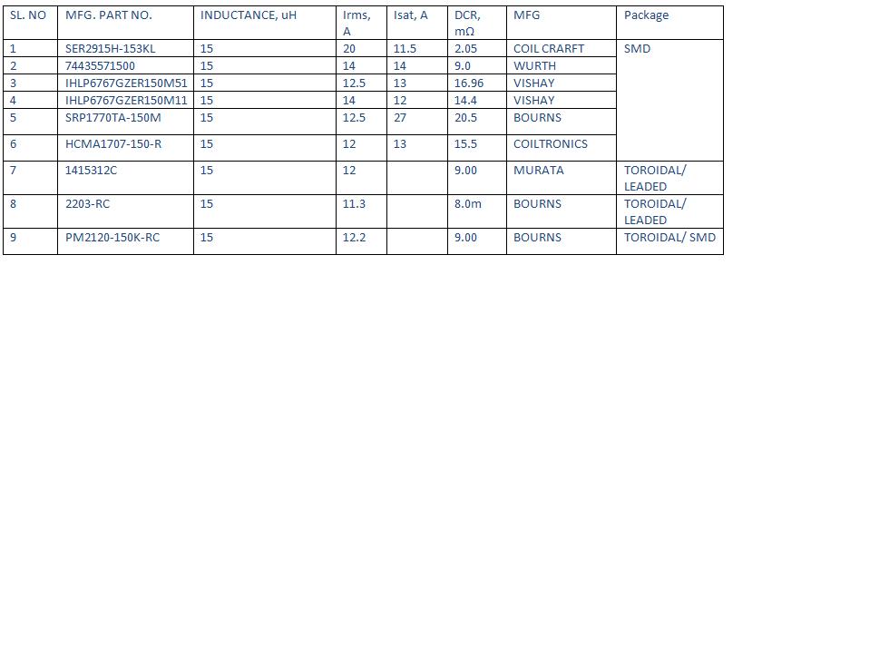

  • Power supply is working fine thank you very much for your support.
    We Kindly  request you to refer the tabulated inductor part suitable for our 48W (12VDC/4A) DC-DC converter with input range 10-28VDC. First two parts are recommended by Webench, but to make the module cost effective  we select the equivalent part as mentioned in the table. And also equivalent high current toroid inductors.
    Can we use the unshielded higher current toroid core inductor for our DCDC converter which can handle saturation problem.
     Please suggest us to select the cost effective inductor.

    You can certainly try.  Please note that unshielded inductors are prone to be more noisey and can possibley cause some noise issues.  I suggest you try a torroid that has an Isat rating higher than your peak currents at your vin min and maximum power out.
    hope this helps?
    Ok thanks alot for your suggestions.
    regards,
    Mohan
