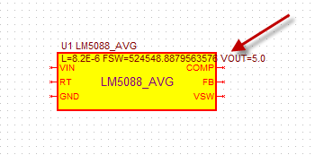

    The average models only model the loop and any parts of the IC that would affect the loop response. None of the average models will have the same number of pins as the actual device. The model is ONLY used for AC response (Bode Plot) of the loop and compensation (internal or external).
    Your generation is completely correct and you should place the device into your schematic using the Insert-->Macro feature once the .TSM file is created and saved to your computer.
    Here is what the circuit should look like once you create it (example for the PSpice reference design):

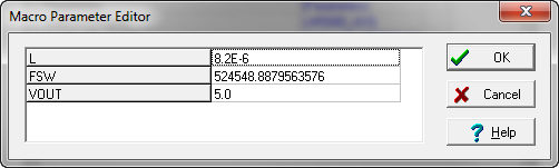

    The PARAMS are being passed into the subcircuit in the TINA-TI model, but they are not displayed by default. In order to see them and edit them for your particular design, enter the macro properties (double left click) and you will see:
    Make sure to check the box to display the parameters.  Click on the line containing the parameters and then click on the ellipsis on the right side of the line:
    Edit the values and save the edits by clicking on OK.
    When you close the properties window, the schematic will update with the values:
    You can now build your schematic around the model. You MUST use the Injection circuit with the large capacitor and inductor (Linj, Cinj, and V2 AC source from the picture). The output cap, inductor, load, FB resistors, and compensation network are then added. The inductor and Vout should match the values in the params statement for the model as these will be passed to the model, not the actual inductor value.

    1.) The value being passed to the model is the L value of the inductor. You were passing 0 which is incorrect. It should be 6.8u since that is the value of your inductor. Please note that you have to specify BOTH values in the circuit. PSpice could use only one parameter. TINA-TI cannot. It must have both the inductor and the L value and both must be the same to get the proper simulation value. FSW is the switching frequency in Hz. I do not think that the circuit is operating at 250HZ, so I set it to 250KHz. Vout is the voltage output that is being set. This must also agree with the FB resistors that are chosen to get the proper simulation. In this case, I left it at 5V (I am assuming that is the Vout value for the circuit).
