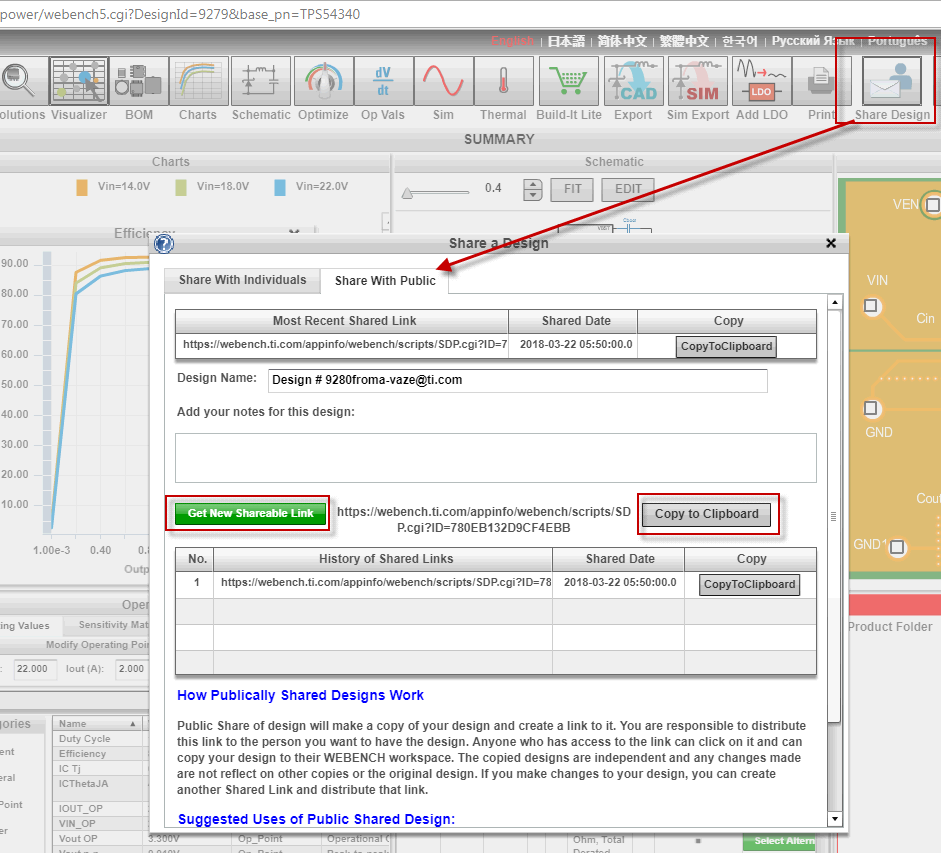

I tried the WEBENCH panel default design from http://www.ti.com/product/lm5175 and did not run into issues when I changed frequency a little bit higher or lower value. Would it be possible to share your design (see snapshot as an example below) and we can take a look at the issue. Thanks for the feedback.

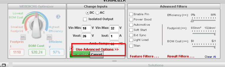

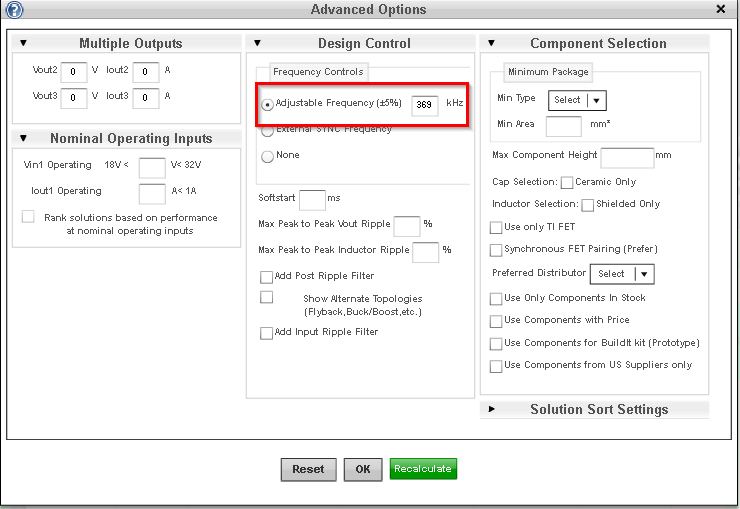

You can also try creating the designs by varying the frequency from visualizer window as shown below.
1. Go to visualizer
2. Click on "Use Advanced Options"
3. Select "adjustable frequency" and chose the required frequency and click on "recalculate".
4. Search for the device and open the design
