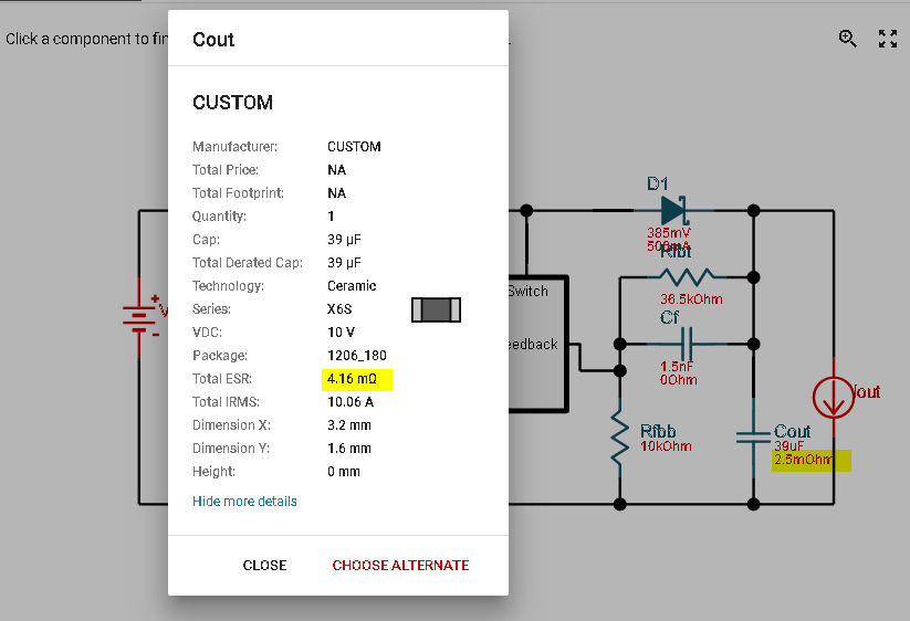

The first problem is that interrogating "More details" for this part shows an ESR of 250mΩ, unchanged from the default capacitor WEBENCH currently suggests for this design:

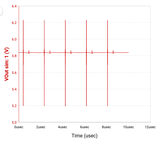

However, the steady-state simulation result shows huge spikes on Vout:

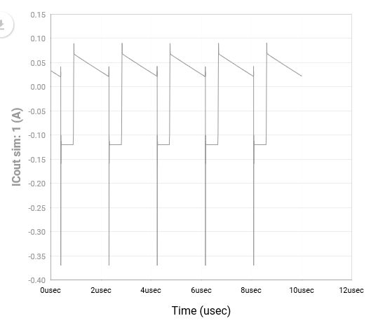

The Vout waveform does not appear to be consistent with the current through Cout:
If the ESR was 1.041mΩ as intended, the spikes on Vout should be about 0.4mV peak-to-peak when the regulator switch turns on and about 0.2mV p-p when the switch turns off, or if the ESR is wrongly using the 250mΩ value the spikes should be about 100mV p-p and about 50mV p-p respectively, whereas in fact they are about 1.1V p-p and 40mV p-p respectively. Also, the other features of the current waveform (roughly rectangular, with droop in the high state) do not show up on Vout, either scaled by ESR or integrated by the capacitance (examples of each are in my previous post "Suggested output capacitor gives excessive output ripple" (https://e2e.ti.com/support/tools/sim-hw-system-design/f/234/t/784345).

    We are able to reproduce issue w.r.t ESR not getting updated when we choose CUSTOM capacitor.
    I tried updating ESR to 2.5mohm. It is showing up as expected in the schematic but has a bug when we click on component to see the properties.
    But it uses proper value (here 2.5mohm) when we run the electrical simulation. We will work on fixing the ESR issue.

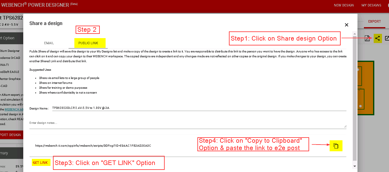

    Kindly let us know if you are observing different behavior. It would be great if you can share your design again by following below procedure.

    As requested, I have shared my same design again as webench.ti.com/.../SDP.cgi. Before sharing it I ran the steady state simulation again (without changing the circuit) and got the same results as before:

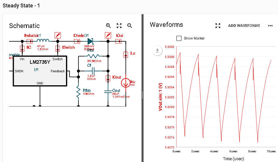

    I then did what you did, opening the design shared by Amod (https://webench.ti.com/appinfo/webench/scripts/SDP.cgi?ID=2E2237E366C1AD75) and modifying it with the same custom capacitor, and this time I got the same simulation result as you did:

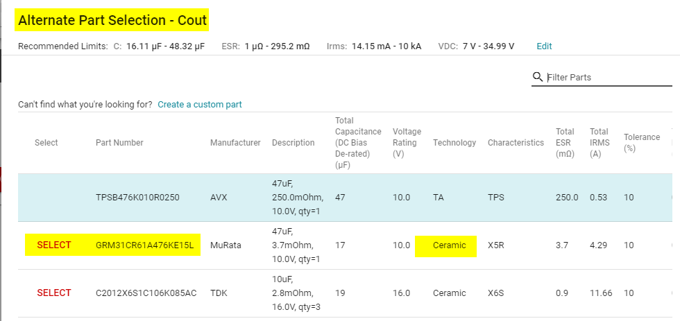

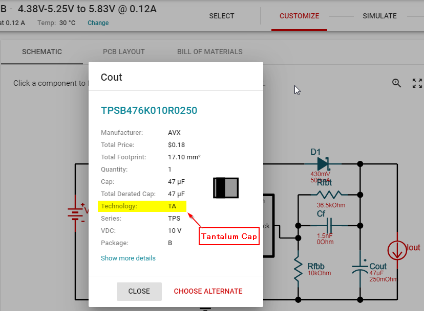

    Inconsistency in your simulation after changing capacitor to custom is due to below reason.
    By default for your input condition (Vin 4.38-5.25, Vout = 5.83, Iout = 0.12) tantalum capacitors get selected. Usually tantalum caps will have higher ESL(Equivalent series inductance ) compared to ceramic counterparts. High ESL could lead to spikes in Vout.
    So when you change capacitor to custom, it takes Tantalum cap model for electrical simulation.
    If you are looking to simulate using ceramic custom cap follow below steps.
    1. First select any of the ceramic cap from the alternate part list.
    2. Then create the custom cap and perform electrical simulations.
    Kindly let us know in case of any queries.
