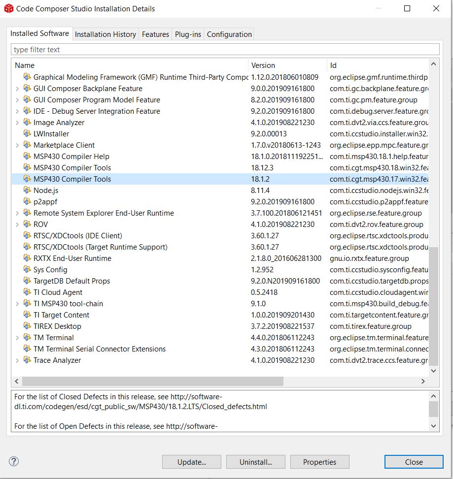

  • CCS is not discovering compiler
    18.1.2.LTS

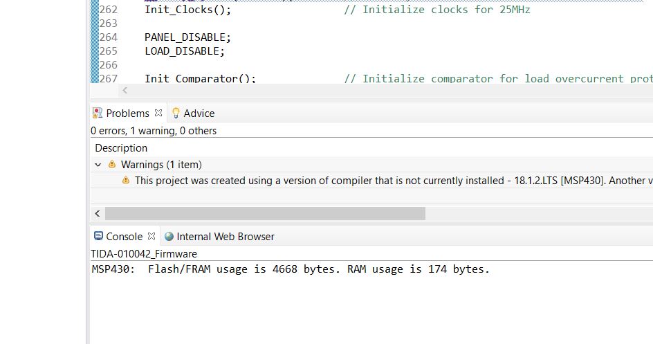

    I am using 18.12.3 compiler but want to switch over to 18.1.2.LTS.
    Can you please run over the process of how I can make CCS discover it and make the warning go away. I have tried downloading it through Help->Install New software
    As you can see, CCS does not recognize the downloaded compiler

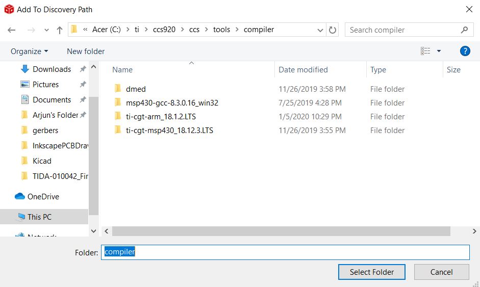

    I tried adding the path but could not find it?
    How do I get CCS to allow me to select the right compiler version so my warning goes away?

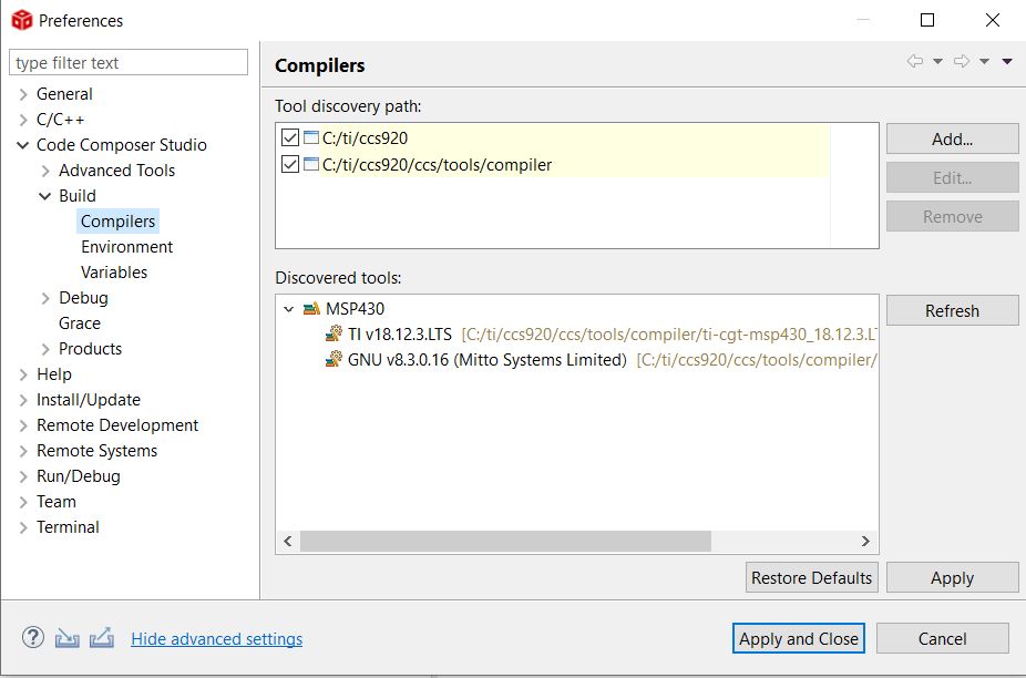

  • Hi Amar,
    I don't see in your last screen shot that version of compiler, so I suspect that's why it's not seeing it.  There should be a directory named ti-cgt-msp430_18.1.2.LTS if you installed it.
    On my computer I copied that version into the ccs\tools\compiler directory.   When I launch CCS, the ide looks for new installed tools (in this case the compiler) and adds it to the proper properties and are available for selection in the compiler drop-down list.
    I guess a better question why don't you just select the latest compiler instead of trying to install this older version?
