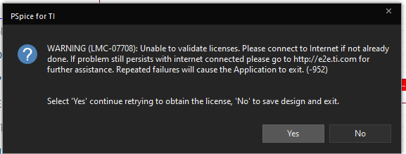

the Pspice for TI is free, right? would you like kindly help check why there is validate license issue?

Could you please open the following URL in your browser: https://cdsplicwc.cadence.com/chws/test/connection.html
If it dos not say "Successful Connection," then there is an issue with your internet connection and you should contact IT. If it does say "Successful connection," would you please send us the installation log, cdsPspiceTIlog.txt, in location %appdata%\Cadence\PSpiceTIInstall
Do not post your license.txt file, but please check that it exists. It is stored at: %appdata%\Cadence\VBL\TI_PSpice_174\license
Please feel free to also contact me or JC through our TI emails.
