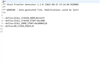

As we can see in the developers guide that ICALL_STACK0_ADDR == (ICALL_STACK0_START +1).
But when I tried to do memory mapping, what I got in ccs_compiler_define.bcfg file is shown below:
ICALL_STACK0_ADDR = 0x11ef1
ICALL_STACK0_START = 0xc000
Can you please tell me what is going in this project? and how to rearrange memory and utilize it fully.

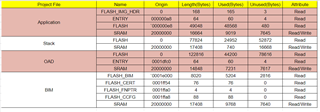

And one more thing, they are using on-chip OAD, allocate 122816 bytes of memory length for OTA, and using 44200 bytes only. Is there any specific reason for this?
