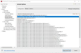

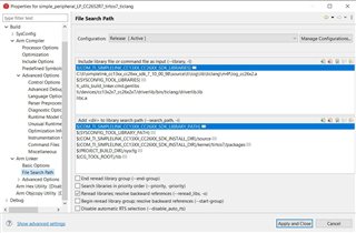

  • Hi Issac,
    Thanks for sharing the detailed process. I am getting error as shown in image below
    I have added the predefined symbol as suggested
    and the search path I gave is as follows
    I also tried adding the path of log folder under properties > Build > Arm Compiler> Include Options
    Garvit
  • Hello Garvit,
    I'm unable to replicate the error you are receiving. To summarize the steps, I am taking:
    1) I added the ti_log_Log_ENABLE to the Predefined Symbols section within the project Properties.
    2) I add the two log modules to the SysConfig, located at SysConfig->Logging->Log Modules. Additionally, I added the same Log Level Configurations to the Global Parameters within the SysConfig->Logging->Log Modules -> Global Parameters.
    3) Added the Includes into main.c and simple_peripheral.c.
    4) Added the log_printf into the main.c file, within the main function.
    5) Debugged and started running the project. Opened Runtime Object View (ROV), navigated to LogSinkBuf, and refreshed the feed to see the log entries.
    (I also added the file search path, and the include option you provided, the log feature worked with these included and without).
    Could you please provide me with the steps you took leading up to the error? Additionally, can you provide me the SDK version you are using?
    Isaac

  • Hello Issac,
    I am unable to decode the reason for the error - fatal error: 'ti/log/Log.h' file not found. I am still receiving the same error after repeating all the steps as suggested.
    Another thing I want to confirm is, in step 2 the log module are added in the log.syscfg so do we need to link it to simple_peripheral.syscfg file in some way because I don't see any log module in it.
    Is there any other way to include the log.h header file to the project ?
    I am working with ccs version 12.2.0.00009 and sdk version 7.10. Since the simple peripheral project attached is for different development board, it is not working with the CC2652R7 boards I have.
    Garvit

    The project you shared is working with the logging activity but I am still not able to figure out the reason why it was not working earlier. I have tried implementing the steps in the simple_central code but I am still receiving same error.
    Did you implement it in a different way for this device? Also, I don't see any additional path added in the "File search path" option in the simple peripheral project you shared.
    Garvit
