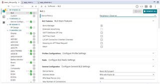

#if ( HOST_CONFIG & ( CENTRAL_CFG | PERIPHERAL_CFG ) ) - How to enable this parameter in the code. I checked in Sysconfig, but this information is not present.
And suggest that which Base project is suitable for this Requirements.
  • Greetings Abinesh,
    If you want to enable the peripheral and observer at the same time for the Basic_Ble example, you can configure this under the BLE settings->Device Role. This will then generate the defines that are necessary to enable the block you have shown. You will see that the generated defines will get placed under ti_build_config.opt
    If you want to achieve peripheral + observer, and be able to use OAD, instead of the basic_ble example, you could perhaps look at basic_ble_oad_offchip or basic_ble_oad_onchip. These, in my opinion, would be more comfortable starting projects for what you and your customer are hoping to achieve
  • Hi Achyut,
    As per the discussion, we enabled both observer and peripheral  mode in sysconfig. But in Observer.c file all are disabled.
    Please share your inputs.
    Have you rebuilt the project after saving the sysconfig settings? The changes will only be visible after you have built the project post sysConfig-modification.
    Achyut Ray
  • Hi Achyut Ray,
    Yes, rebuilded the project after done changes in sysconfig. Even though that code sections are not enabled.
