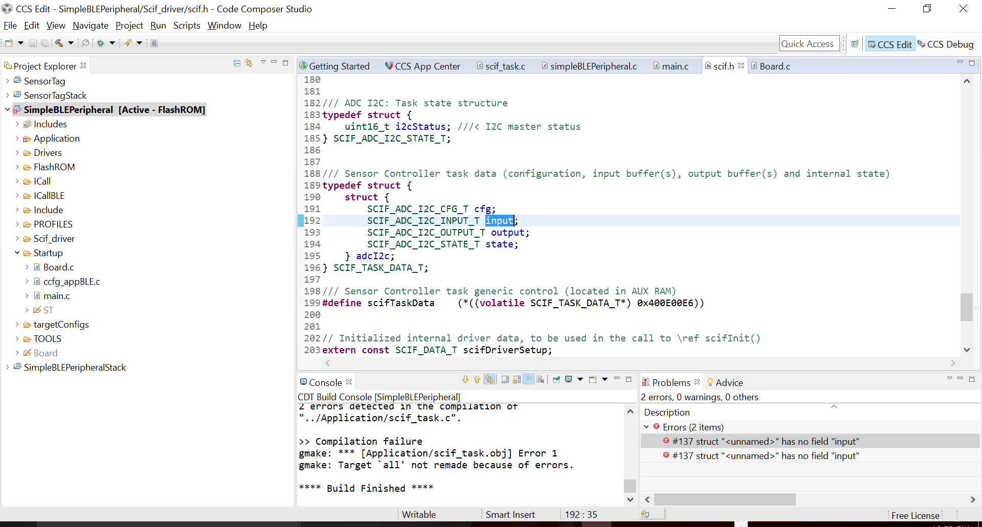

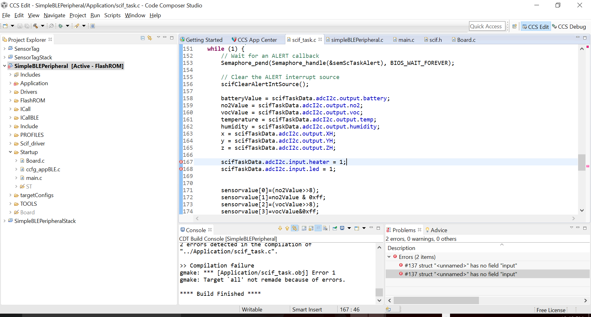

I generated some code using sensor controller studio, I can read the output structure which is defined in the scs, but I cannot write the input data, the error said
#137 struct "<unnamed>" has no field "input" scif_task.c .
I can see the definition of input in scif.h( second picture), so what could be the reason? thanks a lot.

    It is working here.
    Have you made sure to generate the driver files from SCS again and tried to rebuild (clean project -> build project)?
    Is the scif.h file you are referring to in the screen shot above included in the Scif_driver folder?
