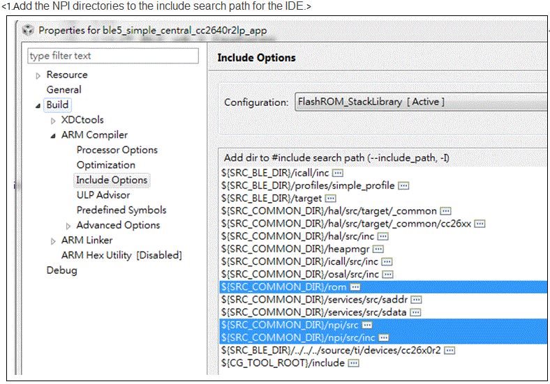

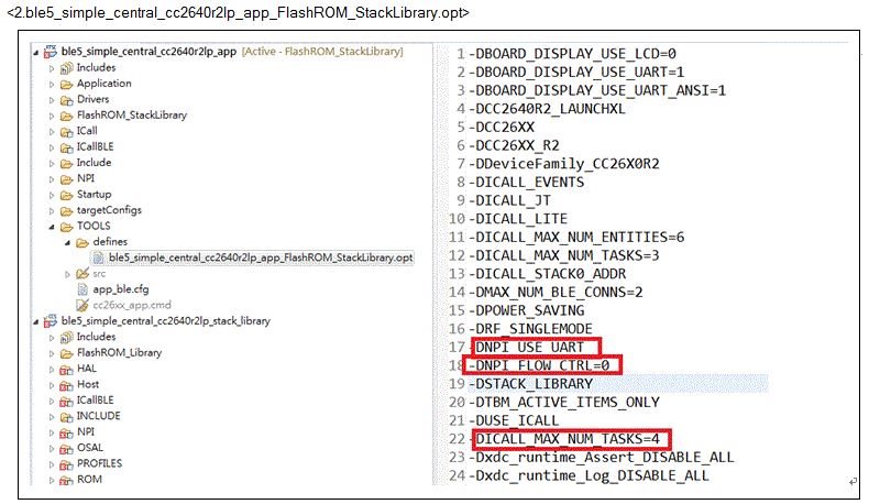

I would like to implement PTM in CC2640R2 and use simple central project.
I followed the guideline (SimpleLink™ CC2640R2 SDK BLE5-Stack User's Guide 1.01.02.00) but encountered a problem.
<PIC: error code>
I also list  the step of implementation as below.
Configuration information:
SDK:  "simplelink_cc2640r2_sdk_2_20_00_49"
CCS: "8.1.0.00011"
  • Hi Ivan,
    It looks like you have both HCI_TL_NONE and also HCI_TL_PTM defined in the build_config.opt file for the stack project.
    This causes the lib search tool to pick out the wrong libraries and probably some #if defined checks to go wrong also.
    Aslak
