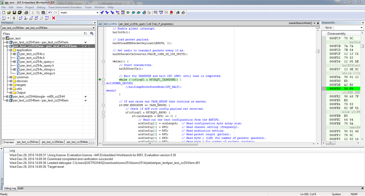

  • To YiKai Chen,
    I don't have the development kit with me so a lot of lcd stuff is needed to be removed from the code segments given. Moreover when I removed the LCD functionalities and tried to implement the core BLE broadcast the debug window was stuck at  the interrupt section. I have attached the screenshot of the debug process where I am stuck right now.
    Kindly help me to get through it.
  • What CC2543 EVB do you use?
  • I am currently using the module given in the website :
    www.ti.com/.../TIDC-MINI-BLUETOOTH-LOW-ENERGY-BROADCASTER
  • Hello Aninda,
    Use the software developed for the Mini Bluetooth® Low Energy Broadcaster board instead:

  • Hello Eirik,
    The errors I got were from the same sode segments given by you. Need some alternatives for it. You can see the pictures attached for more reference.
    Thank you
    Aninda Ghosh
  • Hello Aninda,
    What are you trying to achieve? To simply send ble advertisements?
    DO you have en exact copy of the TIDC-MINI-BLUETOOTH-LOW-ENERGY-BROADCASTER board?
  • Dear Eirik,
    Yes what I am trying to achieve is to simply transmit BLE advertisements. And yes I have the Exact copy of the board.
    Aninda
  • Hello Aninda,
    Then simply use the suggested software (NOT the PER test). and choose the cc2543_weather_station project configuration for the correct board project board configuration. Look at the GenericBroadcaster project.
