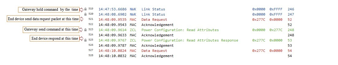

    In the document of "Z-Stack Linux Gateway API", it is written :
    "it is possible that an outgoing request will never get its incoming responses (e.g. when the device being contacted is turned off before being able to respond). For that reason, it is recommended that the application implement a timeout when waiting for responses."
    So I think, the timeout response is not from the ZNP, it maybe is from the Z-stack-linux-gateway. But during 50 sec, there is no response from ZNP too!
  • I would suggest you to use Ubiqua Packet Analyzer to check over the air messages.
  • Thank you for your suggestion.
    Using "Ubiqua Packet Analyzer ", I found that, everything is correct. Gateway as a parent hold command and send it to end device when end device send data_request packet, then end device responds  to the command, BUT the response is not received in z-stack-linux-gateway.

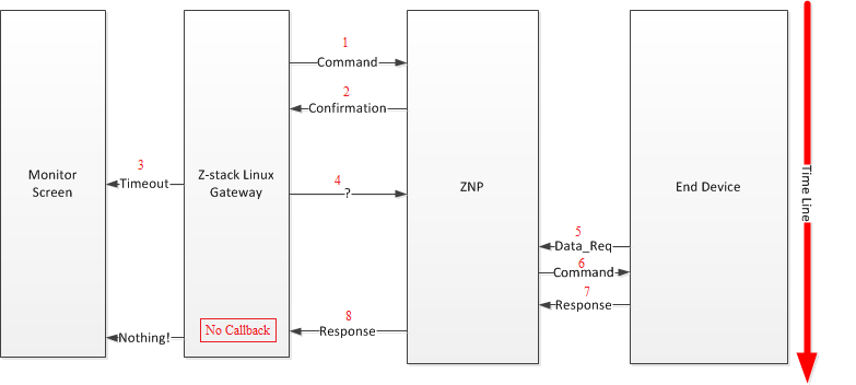

  • Then, you can only debug into Z-Stack Linux Home gateway application.
  • By debugging "Z-stack Linux Gateway" on BBB and "ZNP" on CC2531_dongle_USB  and end-device simultaneously, I found that :
    (1.)Z-stack Linux Gateway transfer a command to ZNP,
    (2.) Z-stack Linux Gateway gets a confirmation.
    (3,4.)Then  Z-stack Linux Gateway writes TIMEOUT on screen and  it also send  something to ZNP  again!
    (5,6,7) after a while, end-device sends packet-request and receive the command from ZNP and it responds to ZNP.
    (8.) ZNP receives  the packet and transfer it to Z-stack Linux Gateway. BUT any function is called in Z-stack_Linux_Gateway!
    note: I also could not find TIMEOUT parameter to set it for longer time.
