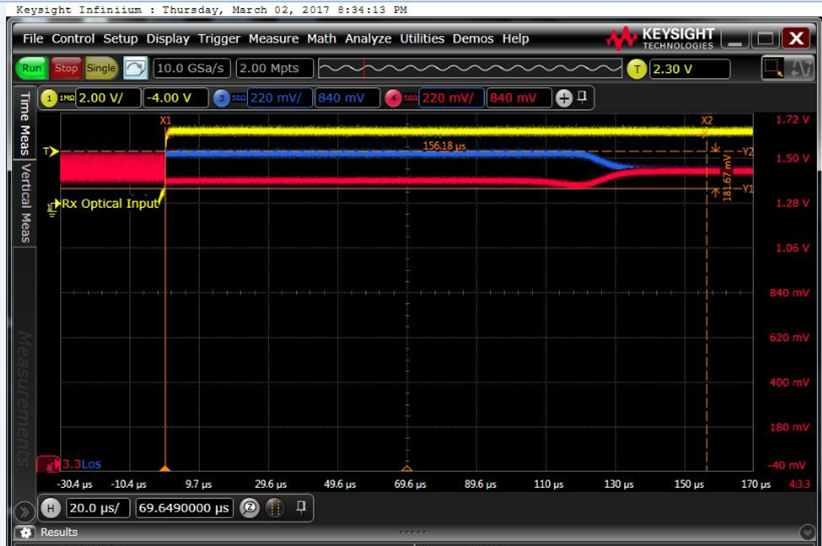

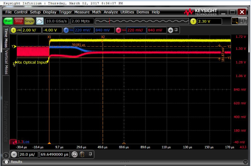

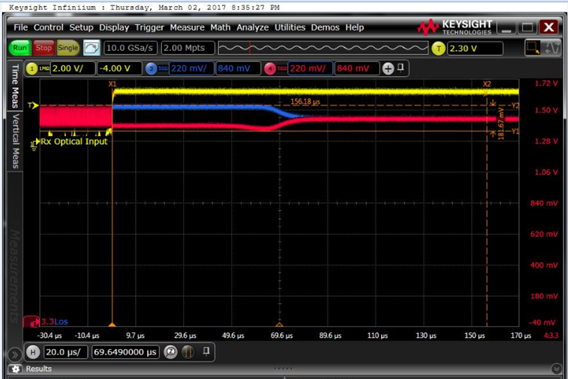

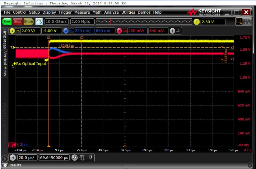

Under the condition of different optical input power,when shutdown the input signal,there are  different output  waveform;as below
RX=-1.0dBm
RX=-5.0dBm
RX=-10dBm,
rx=-15dBm
Questions as follows
1.Under the condition of different optical input power,why the output waveform delay time is different(from max amplitude to min amplitude);the max and min delay time is how much microsecond?
2.in the case of having normal optical input signal, the max amplitude value of output waveform  is how much?
3.if shutdown the input signal,whether the output  waveform amplitude value is more and more smaller?
4.when RX=-15.0dBm,the output waveform with a little more slowly up and down, why such a phenomenon?
Urgent looking forward to your reply,many thanks!

  • hi,loren,
    the query had been got。
    the red trace is on behalf of t he negative output of the onet8551,and the blue trace is behalf of positive output of the onet8551;
    the yellow trace is behalf of the optical  enable signal,low level rerepresent  a light signal input,high level represent shutdown the light input;
    diagram as below。
     the customer mainly care  the max delay time is how much?
    and different power signal input,the output  amplitude weather same?if different,the max and min amplitude is how much‘?

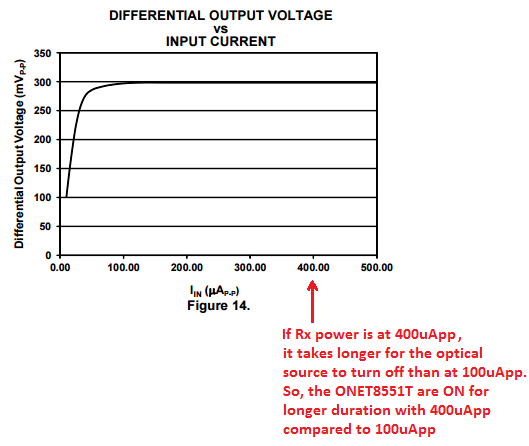

  • Hi Cickey,
    It looks like even though the optical source is disabled, it takes a while for the optical source to completely shut-down (or no light) from the moment it is disabled. Higher the optical power output present from the optical source, the longer it would take for the optical source to completely shut-down (or no light) from the moment it is disabled.
    The ONET8551T is a limiting amplifier, where the differential output voltage is fixed beyond a certain input power level. So, if the optical source takes some finite amount of time to turn-off depending upon its power level (longer time to turn-off for higher power level), then the ONET8551T outputs will be on for the same duration until it is no more limiting and eventually turn off.

  • Hi Cickey,
    The ONET8551T has 9GHz bandwidth, which means the rise/fall time of the signal is tr = 0.35/BW = 39psec. So, it does not really explain that the TIA would be adding usecs of delay time at the output when the input signal is shut-down completely.
    I feel that even though the laser is completely shutdown or disabled, there is still some residual power or light present at the ONET8551T input which causes its outputs being present in the usec duration depending upon the input power level.
    Rohit
