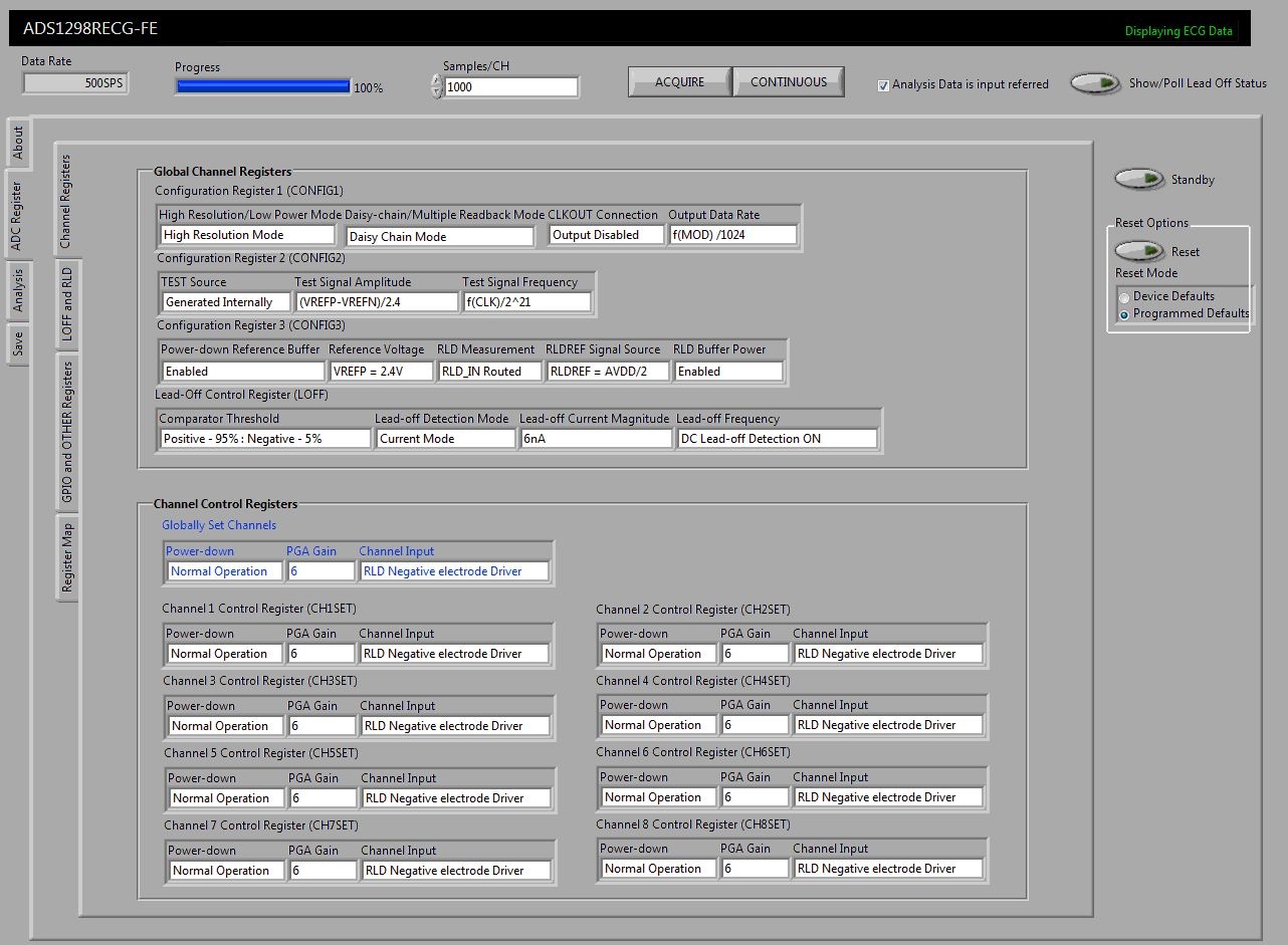

  • Hello Brian,
    I have tried using RLD amplifier with the reference board using utility provided with the development board.
    But I am not getting any waveform with the settings I am doing. Please check the settings with the attached snapshot and let me know where I am going wrong.
  • Ajinkya,
    Set the channel inputs to "Normal" and then in the "LOFF and RLD" tab, select which inputs to use for right leg drive inputs. On the EVM you can at least use all the positive inputs and IN2N and IN3N.
    Brian
