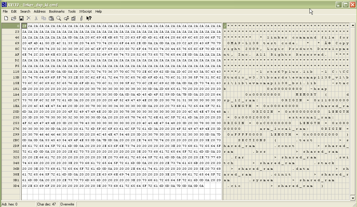

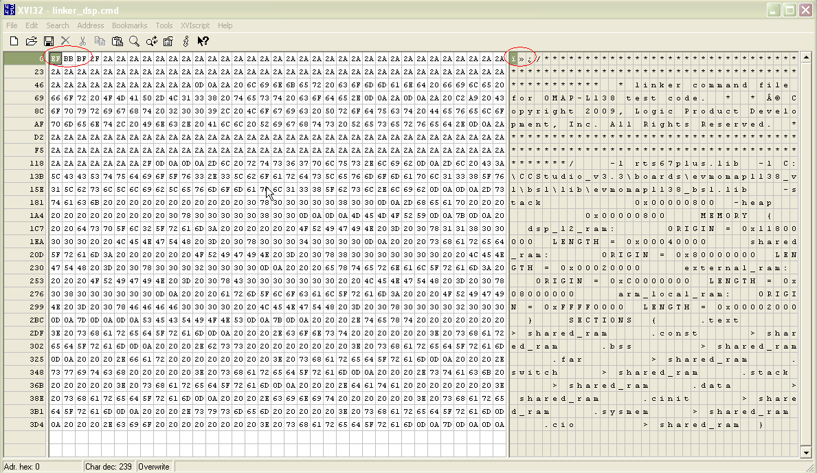

  • I got the exact same problem (unrecognized file) when using notepad to edit the linker_dsp.cmd file.
    I was able to solve it by using CCSv4 to edit the file. It turned out that notepad by default saved the file in UTF-8 and added a 'byte order mark' (EF BB BF).

    Here is my linker_dsp.cmd file.  It is three bytes larger than your file, but the differences are invisible to the eye (in the CCSv4 editor and MS Notepad).
    [P.S.  The "Insert Media" command does not appear to be working.  I've tried uploading my file five times now, and it doesn't seem to show up.  What's up?]
  • Hit the Options link and use the File Attachment option to upload the file
  • Did the file upload yet?
    linker_dsp.zip
  • Yup. Got it. I did a diff using a diff tool and the tool said that my cmd and your is different. But when the diff tool then opened up both files side-by-side, the files looked identical. I even enabled display of special characters and still the same. But dropping in your file in my folder, i got the same linker error. So I open your cmd file again in my editor and used the built it DOS format conversion tool and saved the file. The errors went away.
    I don't know how that cmd file was some format besides DOS (Unix? Mac?). Do you use another machine besides PC? Maybe you have some setting for defualt file format and it is not DOS?

  • I can spot the difference with a binary editor. Thee characters in the beginning of Walter's cmd file that does not exist in mine.
    Mine:
    Walter's:
    The original file from Logic PD does not have those extra characters either. Somehow, someway those characters got added when Walter modified the cmd file....
    strange!
    strange!
    Actually not so strange:
    http://en.wikipedia.org/wiki/Byte_order_mark#Unwanted_BOMs
    http://www.howtofixcomputers.com/forums/windows-xp/extra-characters-beginning-file-ef-bb-bf-263070.html
  • Yes, I believe the problem characters were not in the original LogicPD linker_dsp.cmd file.  However, the wrong library path was there, so I was forced to edit the file to correct the path.  I used MS Notepad to do the edit.
