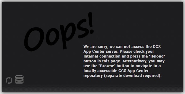

CCSv6 doesn't connect to App Center
Hi
From a couple days my CCSv6 refuses to connect to App Center:
My internet connection is normal. I didn't touch in firewalls configurations, NATs or anything in my router. I am using Windows 8.1.
I wondered that could be my anti-virus. I deactivated it, but the same.
Windows 8.1, as usual, receives almost daily updatings. Perhaps one of this update modified something in my computer?
Can someone indicate a way to solve this issue, please?
Thanks.
Sergio

  • Were you able to connect to App Center in the past and this is a recent issue? Did you try using a new (clean) workspace folder?
  • Hi Ki
    This issue appeared last week. Until then, I was able to access App Center without problems.
    I tried several workspaces, including the original 6.1 workspace and a new one, but, unsuccessfully.

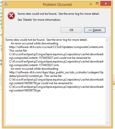

  • Hi Danishinnis
    I did what you asked and follows the sequence:
    It took several seconds to display this final message.
    All errors appears to be related to inability to write to some files. I know that Windows 8.1 behave in different ways ( comparing with W7 ) concerning to user rights regarding to read/write on folders and files.
    In time, I have administrator rights in this computer.
    Sergio
