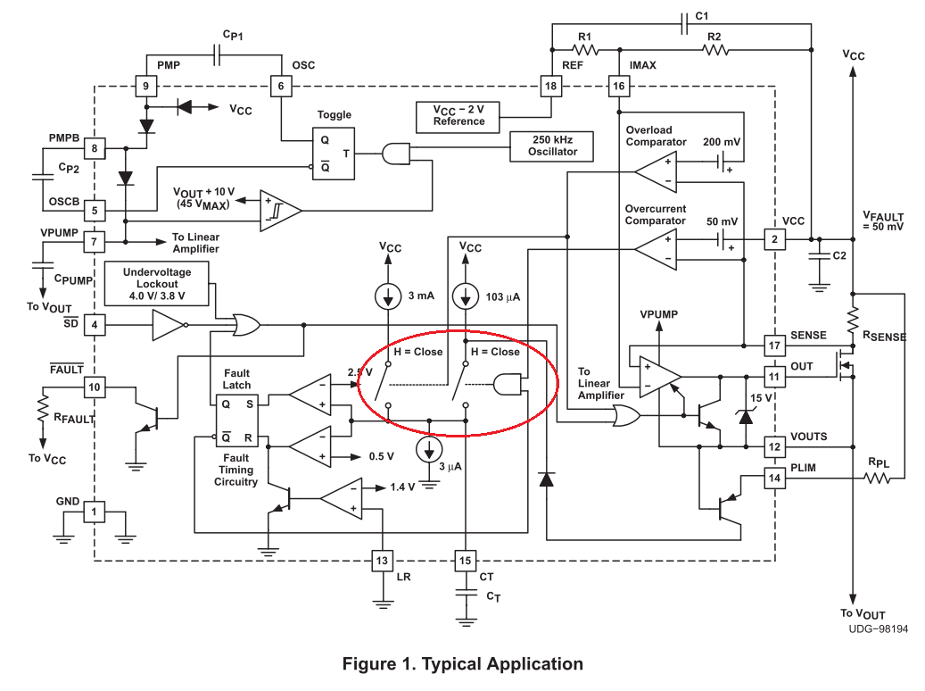

Hi all,
Would you mind if we ask uc2914?

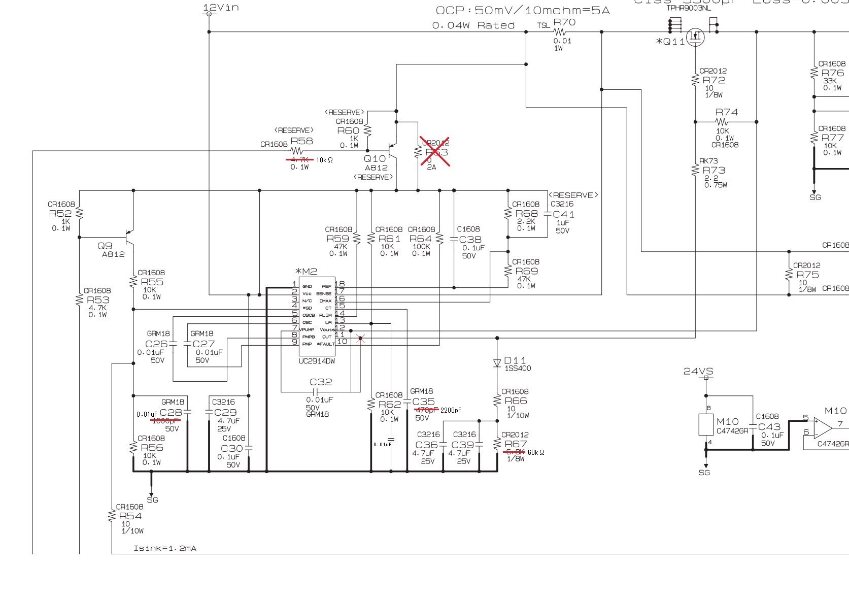

Please refer to following circuit.
4062.20141205_UC2914_circuit.pdf
We have some following questions;
<Q1><Q2>
3821.20141205_UC2914_Q1,Q2.pdf
<Q3>
0564.20141205_UC2914_Q3.pdf
Is this operation correct?
Kind regards,
Hirotaka Matsumoto
    Below is my understanding based on the datasheet text:
    Q1: And then, after Overcurrent load, if SD pin set to low, the output didn't restart. Is this operation correct? The restart behavior is controlled by the LR pin (LR=high means latch off after fault and LR=low means retry after fault). If LR=high and a fault occurs then SD must be toggled from high-low-high to restart. Pulling SD=low anytime turns off the power switch.
    Q2: If SD pin set to low, is "Output Latch-off" released? Furthermore, LR pin is added 6V. The state of the device will remain OFF if SD is pulled low after a fault (while LR-=high). To restart, SD must go high again.
    Q3: There were chatterings at 4pin(SD), the voltage of CT increased, after that, the output voltage stoped. Abnormal and unpredictable operation can occur if there is noise on any hotswap enable (including UC2914 SD pin). Adding a small value capacitor can help filter unwanted SD pin noise.

  • Confirmation #1: Yes, your recognition is correct.
    Confirmation #2: This is a general comment for any hotswap. The enable input pin (SD for UC2914) must be stable (without noise above/below the threshold) for predictable operation (ie, well above the ON threshold or well below the OFF threshold).

    <About Q1>
    We confirmed the condition of our customer's setting.
    -LR pin remained High.
    -SD pin remained High(it was not toggled H L H).
    So, even though the setting is the latch-off of the output after a fault, after the output stopped, the output restart to operation 5V we mentioned before.
    <About Q2>
    "The state of the device will remain OFF if SD is pulled low after a fault (while LR-=high). To restart, SD must go high again."
    So, we got the method to restart,  but in this case, the fault latch off will be released or not?(it doesn't show on the datasheet)
    As the result of our customer's test,  the fault latch off was realeased and restarted.

  • Eric san,
    We'd only like to mention about SD-pin ON/OFF chattering.
    If you have some advice, could you let know us?
    (Of cource, you don't have it, don't mind it)
    On the block diagram, according to SD on/off, we guess that CT is charged  momentarily.
    (If defalut is H-close.)
    So, on our customer's circuit, CT=2200pF, PLIM=48kohm.
    Compared with your reference circuit, the value of CT and PLIM is smaller(CT=0.1uF, PLIM=76.8kohm).
    So, it adversely affects to charge(charge and discharge time will be short.) .
    Is our recognition correct?
