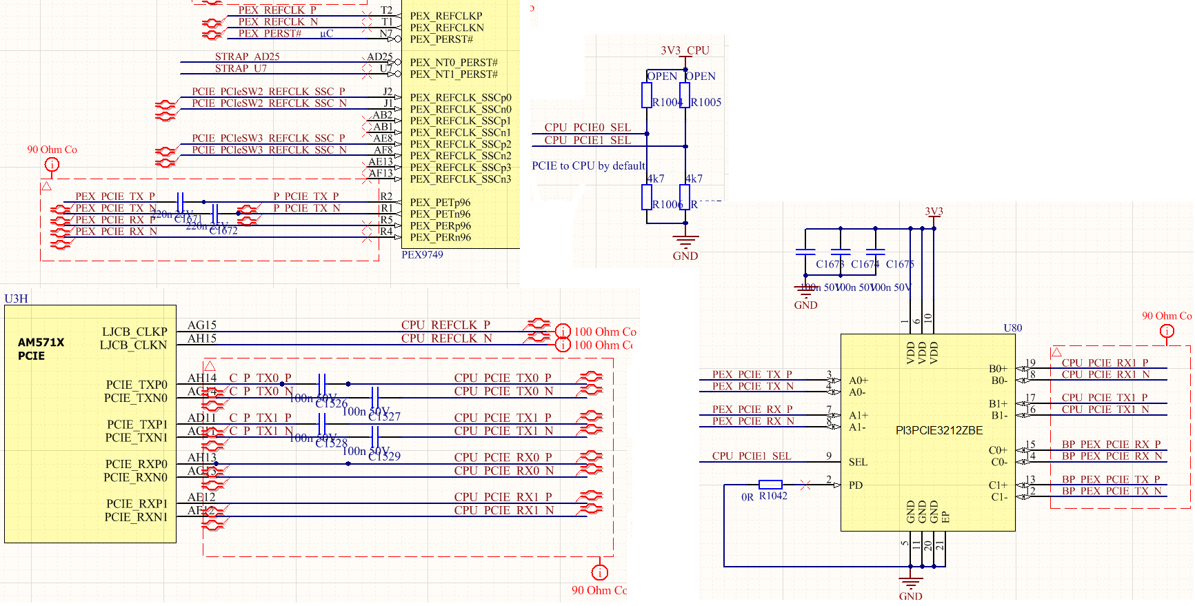

We have a custom board with AM5716 connected to PEX9794 and A 10Gb Ethernet switch via the two PCIe interfaces. Sometime during the initialization, we get the error:
omap_l3_noc 44000000.ocp: L3 application error: target 5 mod:1 (unclearable)
omap_l3_noc 44000000.ocp: L3 debug error: target 5 mod:1 (unclearable)
In such cases the PEX9794 is not recognized on the PCIe bus but the other device is there. When probing the non-working case it can be seen that PCIe lane from PEX9794 is still active but the lane from the AM5716 is silent.
I have studied the related questions in the forum and it seems that there should be a power/reset problem but after checking all related signals, I have ran out of options. The current workaround is a complete reset. Is there a way to reset the PCIe bus of AM5716 and do a rescan inside Linux?
Here is the log from a working and non-working case.

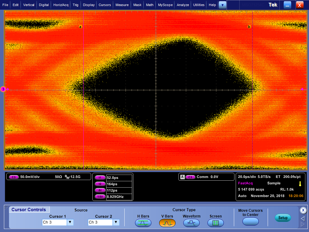

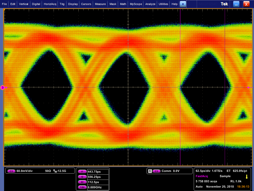

    I just probed the received PCIe signals near Sitara and PEX side with TriMode probes and our high-end oscilloscope. You can see the eye diagrams here. As can be seen for the working condition, there are good eyes and the link is established in Gen 2. So it does not seem to be a signal integrity problem.
    PEX Rx:
    AM5716 Rx:
    For the non-working condition the PEX output is Gen 1 and there is no signal received by the PEX from Sitara.

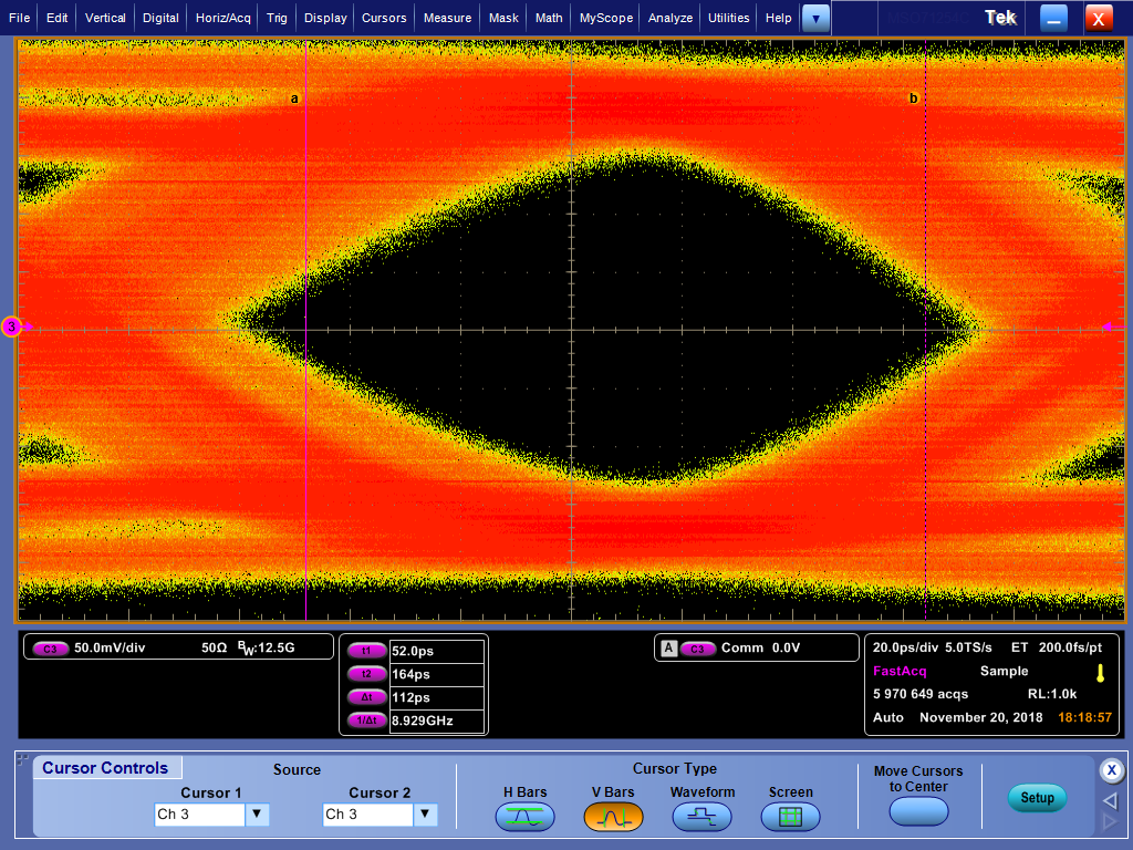

    AM5716 Rx:
    Using the following workaround solution did not help as well and the Sitara PCIe output is still off. ()

    Here is the PCIe schematic portion. A short description is that we have a PCIe multiplexer (PI3PCIE3212ZBE) in the middle which connects Sitara and PEX by default. The 3.3V power (like all other power rails) comes long before the PEX is out of reset. The clock is coming from the same PCIe clock generator for both devices. It is important to notice that the exact same circuit (same PCIe MUX, same clock source...) is used to manage a 10Gb Ethernet switch via the other PCIe port (port 0) which is working fine all the time.
    The trace length is almost 27 cm and 23 cm for Sitara RX and TX (including both sides of PCIe MUX) respectively.

  • Thanks Meysam.
    What is the PCIe tracelength from SoC to PCIe MUX?
    I've asked Rex to chime in for your "limiting PCIe speed" question.
    20 cm and 19 cm for RX and TX lanes respectively.
    Meysam

  • Hi Meysam,
    Your trace lengths significantly exceed the maximums permitted for this device. I think it likely that the SoC PCIe SerDes is having a hard time linking due to the resulting insertion losses.
    Please refer to SPRAAR7 for more detail on high-speed layout guidelines and requirements.
