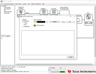

  • I know it is bad form to answer your own question but I went ahead and tried this. Yes, it is possible to use an MSP-EXP430F5529LP LaunchPad Kit as an USB2ANY with a minor modification. The 4MHz resonator (Q4) needs to be replaced with a 24MHz crystal. I am able to use such a board to communicate with an LMX2491 PLL using TICS Pro.
    Start with an MSP-EXP430F5529LP and replace Q4 with a 24MHz crystal and associated load capacitors. Download USB2Any Explorer and upload the firmware included in a subdirectory to the MSP430F5529. You can do this by putting the MSP430F5529 into Bootstrap Loader (BSL) mode and using USB2Any Explorer or using UniFlash and the on-board debugger. Note that TICS Pro will automatically downgrade USB2ANY firmware to 2.7.
    It would be helpful if TI were to distribute versions of the USB2ANY firmware that work with a 4MHz crystal/resonator, specifically the version needed by TICS Pro (currently 2.7.0.0).
    The bootloader still functions after the crystal change as it checks for common crystal/resonator frequencies during initialization. Refer to the MSP430Fx5xx Family User's Guide (slau208q) Pg#1127. Please add this feature to the USB2ANY firmware.

    TICS Pro will automatically downgrade to 2.7.0.0:
    Successful communication with an LMX2491:
