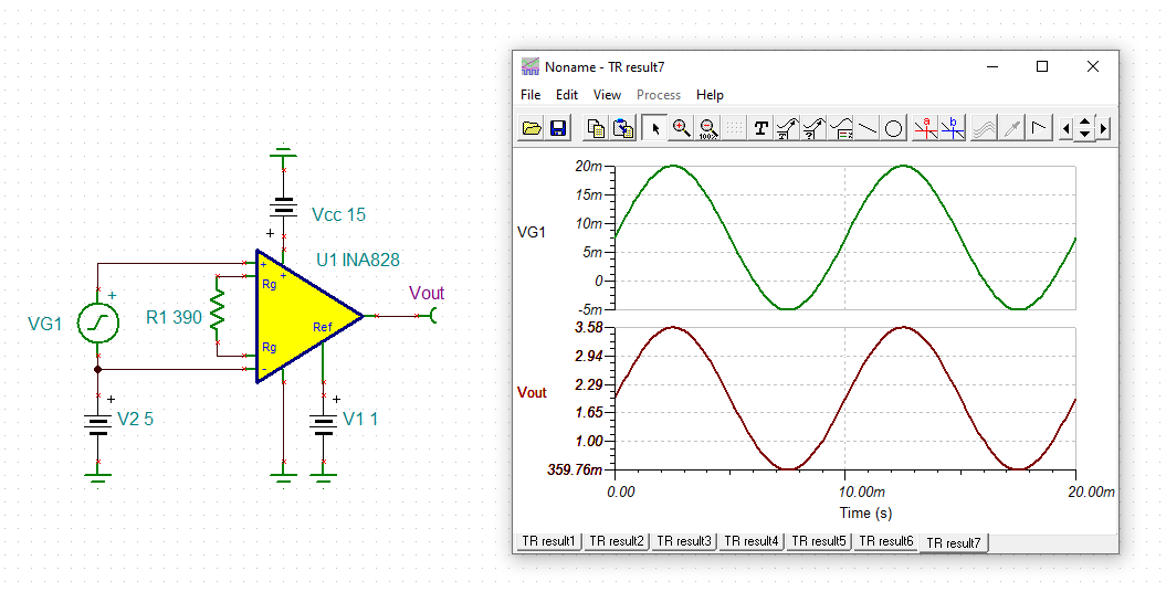

I have a loadcell which gives a differential output of 0-20mV with the INA828 connected to this to produce an amplified single-ended output of up to 5V which is connected to an ADC. I would like to know if there are any solutions for getting a differential output from the amplifier?

Hi Kai,
thanks for the suggestions.
My circuit for each amplifier is something like this.
I will have 16 of such setups and the outputs would travel through individual cables to the adc. All the boards will get the same +15V and ground from the power supply(ie in parallel). The -15V for the amplifier's negative power input and 10V for the loadcell is converted on the board itself. Each loadcell will get its ground from the amplifier board which takes its ground reference as the ground input of the power supply to the board. My design isn't fixed yet so I'm open to any suggestions for improvements!

Hi Esther,
As Kai suggested, you may go with the load cell's front end as shown in the simulation below. If the +15V is regulated out of a linear LDO, you may use as is. If it is regulated from a switching power supply, then you may consider to filter it out further and reduce to 10-12Vdc to reduce noise and ripple. In other words, it will be beneficial to simplify and lower the noise at the instrumentation and load cell input stages, also make it as small as possible so that the sensing system may be able to be shielded effectively (I did not configure the gain stage properly, if you are looking for 0-5V range for your ADC. This is just an example.).
INA828 0-20mV 0-5V Load Cell 02092022.TSC
If the load cells are surrounded with larger or industrial motors, you may consider to use ferrite beads/core to eliminate additional EMI/EMC noises.
Regarding to the output coupling, I will go with Kai's recommendation. If the signal cable bundles are shielded, you may go with single-ended inputs to ADC.

Thanks for the reply. Could you elaborate on how setting the offset voltage to 1/4 of the reference voltage of the ADC would allow some negative going load cell signal, unless the offset voltage is negative?
My application is medical so I don't think I can connect the signal ground directly to the motor chassis, it would have to be done through capacitors. In this case, how would adding the isolation amplifiers after the signal has already been amplified help when the noise is already coupled from the loadcell?
Hi Esther,
assume your load cell signal is going negative by 5mV. Further assume an ADC with single ended inputs and a reference voltage of 4V. Then connecting about 1V to the REF pin of INA828 will do the trick:

Thanks for the recommendations. I would like to have a 0.4V reference for the INA828 to offset the output signal. Would the circuit recommended in the datasheet be suitable with the relevant resistors or are there alternative solutions?
Hi Esther,
the specifications of common mode rejection and open-loop voltage gain of OPA191 say: yes this will work at 0.4V input voltage and 0.4V output voltage of OPA191.
Take 10k for the lower resistor, though, and 115k for the upper resistor (both within the E48 series). This gives an auxiliary voltage of
5V / (10k + 115k) x 10k = 0.4V
But keep in mind that the precision of 5V and the manufacturing tolerances of resistors in the voltage divider have a direct impact on the precision of your 0.4V auxiliary potential. If this cannot be tolerated, a more precise reference voltage and/or more precise resistors (e.g. +/-0.1% toleranced) should be chosen.
