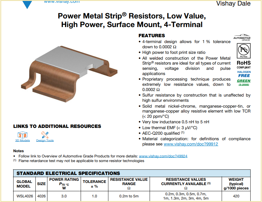

  • Hi Hrishikesh,
    I heavily recommend to use a four terminal shunt supporting 4-wire connection. See section 10.1 of datasheet.

  • Hi Hrishikesh,
    the fact that your values are 6% too high means that your shunt resistance is 6% too big. The reason for this discrepancy is very probably the additional resistance of the soldering of shunt. That's why a four terminal shunt is heavily recommended whenever the shunt resistance is in the same range like the resistance of soldering, as in your case:
    Connect the wires running to the load and to power ground to the too fat terminals of above four terminal shunt and connect the input pins of INA185 to the two tiny terminals of above four terminal shunt. Don't confuse the different terminals and don't make any interconnections as this would destroy the perfomance.
    Having made the connections properly, the voltage drop across the solderings at the fat terminals would not be seen by the tiny terminals Relaxed
