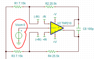

Why not directly connect with GND in your simulation file you gave? a cap needed? We are updating our schematic now. We are wondering if we need a capacitor here even if Vocm is referenced to GND.

    A bypass capacitor on Vocm is often used to reduce noise when is connected to a reference voltage (often there may be a resistive divider to generate this VOCM voltage). Also, in the case where VOCM is floated to obtain the default mid-supply bias, the decoupling cap is used to reduce noise due to the internal high-impedance divider.
    If you are connecting Vocm to analog ground using a short trace (assuming this is a clean, noise free analog ground plane/connection on an optimal/proper PCB layout), the bypass capacitor is not required.
    If you are referring to the stability analysis simulation that Kai provided in this post, there is only a 0V supply bias on VOCM (equivalent to VOCM connected to GND) but I don't see any capacitor on the VOCM pin

    I use +15V and -15V, and the mid-supply bias is 0V ideally. I don't know if the analog ground is a clean, noise free or not. I guess it won't be in real life. Can I tie it to GND or I need a capacitor on VOCM then to analogy ground? I am just confused here. If I tie VOCM to ground, VOCM would pick up some noise because the ground in real life is not clean and noise-free and if I let VOCM float to the default mi-supply bias, then the VOCM is not 0V due to the difference between real +Vs and -Vs.
    Directly to ground or through a cap to ground for VOCM pin? Please advise.

    section 8.2 of datasheet shows how VOCM is set at midsupply, by the help of two internal 5M resistors. So any noise coming from the supply rails will make VOCM look noisy. The best cure to decrease this noise is to connect a filtering cap from the VOCM pin to signal ground.
    But when you externally connect a voltage source to the VOCM pin, and do this low ohmically, example given by connecting VOCM to signal ground, no such filtering cap from the VOCM pin to signal ground is necessary, of course.
    That in my simulation VOCM was connected to a voltage generator sourcing 0V has no deeper sense. And in TINA-TI a voltage source also has a low ohmic impedance to signal ground.
    So, if you want to connect VOCM to signal ground in your application, do this. And you don't need a filtering cap at the VOCM pin. But be sure that you have a good signal ground in your circuit, by using a solid ground plane.
