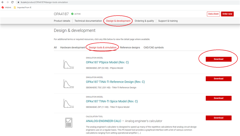

We are trying to do AC and Transient modeling of a circuit with the OPA4188 and OPA4187 with TINA, and would like to get spice models for these devices. Where do we go to look for device models? These do not show up under the "Spice Macro" drop down.
Conrad,
All macro-models including PSpice models are located in each product folder under Design & Development -> Design Tools & Simulation tabs - see following links:
https://www.ti.com/product/OPA4188#design-tools-simulation
https://www.ti.com/product/OPA4187#design-tools-simulation
