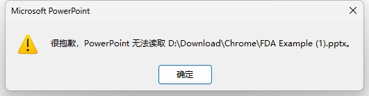

  • Hi Sima,
    Your reply solves my doubts, thank you very much.
    but is the ppt file broken?
      I am glad it helped!
      I am reattaching PowerPoint and simulations, let me know if these work.
