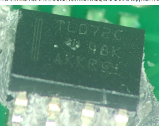

  • Hi Team,
    I have ordered samples on TI website for this part TL072CDR part & received sample have batch code details of 3CK, AE7164.
    with this functionally working fine, attaching here pic. for your reference
    where as currently I am facing the problem with 48K, AKKR 64 batch which are there production lot 2500 no.s...attached pic is for your reference
    I guess is there any specific batch issue / Manufacturing site location shall we decode from top marking.
    batch code details decoding plz suggest also.
    Rajani.M
  • Hi Raj,
    The first two number/letter combinations of the middle marking indicate the date the device was manufactured.  For the first device, the middle term is "3CK", this means it was manufactured in 2023 and the "C" refers to December (dates are: Jan = 1, Feb = 2...Dec = C).  The second device was manufactured in 2024, in August (8).  However, the PCN states that devices could have been shipped as early as  September, 2022.  The only way to know from the marking if it is old/new die is if it pre-dates Sept. 2022.  Since that time, it is possible that it could be either die.  Unfortunately we have no way on the apps. support team to give you any further insight to specific lots.
    I hope this helps,
    Mike

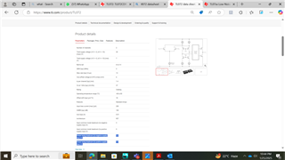

    By comparing old & new data sheet I also found functional block diagram change, older one with transistor based, recent one with FET based.
    Above I have shared my circuit design details with input range, did you able to see any flaw with it. Input is on 5.5 +/ 1V range.
    Is there any input & output impedance mismatch due to this after PCN, datasheet parameters wise no change but.

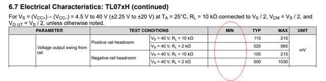

  • Rajani,
    • Thanks for taking the time to put together this excellent summary.  This helps a lot!
    • I think I understand the problem.  I believe the issue is that the output swing limitation on the new die is improved as compared to the old one.
    • Output swing is a measurement of how close the output signal can get to the supply rail before it clips (or distorts).
    • Normally, it is considered good performance when the output signal can swing close to the supply rail.  However, in your case I think your design relies upon the swing from the supply rail being away from the supply rails by some amount.
    • If you like, you can send us an old and new device and we can run a characterization to prove that.  You can contact me through e2e chat (I can't post shipping info on a public web site).
    • Assuming this is the case, I am not sure we will be able to help from the device perspective.  The reason is that the minimum swing to the power supply rain is never specifies (on any op amps).  This is because the minimum should ideally be 0V and the output should ideally be able to swing all the way to the power supply rail.  For any op amp there will be a statistical variation in the output swing.  For this device with a 10k load the output swing can be as much as 210mV from the supply rail.  For this load the typical output swing will be 115mV, but there is no specified minimum output swing.
    • I think your design could be modified to clip at a lower voltage level by adding a circuit element.  For example, we could use a Zener (or two Zeners) to clamp the output below the power supply.  If you need that clip to occur this is really what should be done as compared to relying upon the op amp output swing to be at a certain level.  Even if we could find an op amp that would behave similar to the old TL072C, there is no guarantee that across process variations that the minimum output swing would remain consistent.  Thus, to make this design robust from a long term perspective the we should make a hardware design change.  Do you have the option to modify the hardware (e.g. add additional components)?  If not, can you substitute components? For example, could you replace C9 with a diode?
    Sorry for the difficulty you are having.  I think your last post gave us an understanding of the issue.  Now we just need to think of how to solve the problem.
    Best regards, Art

    Plz update datasheet parameter forTL072CDR Min peak output swing parameter w. r. to recent PCN wise.
