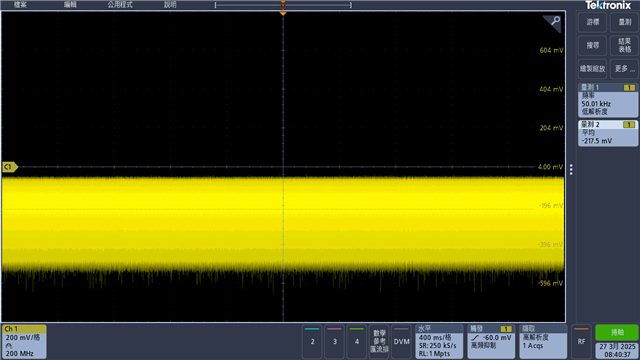

  • HI sir
    We production hi-pot tester ,and sales to the worldwide, you can see the below figure, IC27 is VF signal from 5kv resistor divider, close loop circuit
    use the old date code, the VF is stable as below left.
    use the new data code, the VF is unstable as below right.
    We also use the OP07 in other circuit, likes the sample -hold circuit, still unstable,
    we already try to add 1000.450p ,100p in front of the AMp, or in back of the amp
    still no any improve,
    did you have any advise.thanks?
    RUN rate 30k
    may i know the BW diff between new & old,thanks

  • hi Raymond
    q1:HV node Connect  to 2 stage filter as below, then go to ADC(AD7606)
    q2:we follow your test method, in series a 100 ohm & use the short probe to measure, we can see the offset is Thick, and the VF waveform also
    oscillatory behavior at output

    The plot below has op amp oscillatory effect at the op amp's  output, and it needs to be compensated for the new FAB.
    Could you try the parallel 470oF over 3.01kΩ resistor, and see if you are able to remove the oscillation?
    0525.OP07C Oscillation issues in TW 03262025.TSC
    Meantime, I am trying to get additional information about the validation data on the part.
    Raymond

  • hi Raymond
    follow your rule , parallel 470oF over 3.01kΩ resistor, the result as below, level shift to negative postion
  • Hi Alex,
    Sorry, the suggestion did not work out.
    Could you confirm where you are probing the test point in the following schematic? My understanding is that you probed at TP20, where the oscillatory effects are observed. Maybe I was misunderstood.

  • Hi Raymond
    On the schematic, I am trying to locate IC27, VF node and 5kΩ resistor divider, but I am unable to locate it. Please indicate the probe location and related behaviors.
    a: yes, measure the waveform from IC 27 ,TP 20.
        not the 5kΩ resistor, in from of the IC27, The signal is come from the
        5000v output, which Attenuation by resistor divider
    We use the op07 in different pcb, and module, many PCB need to be adjusted.
    that is the big engineering, did you get the same issue from other Country?
  • Hi Alex,
    You are the first customer has issues with this OP07C part. The open loop output impedance on the new op amp did not change significantly, though the GBW is increased to approx. 1.1MHz range. So it should not have the oscillation issues that I can think of. The validation data in OP07C indicates that the new design is very similar to the old FAB, and you should not see such issues for this particular design. So I am not sure that I understand the real  problems, and I need more information from you.
    The IC27 circuit has gain of 4V/V and the circuit should have enough phase margin without oscillation in the new part. Could you answer my following questions.
    1. Did you have bypass capacitors placed next to ±15Vdc at IC27 or OP07CP op amp? I suggested to use 1uF, low ESR caps next to both ±15Vdc pins of the op amp. Without these bypass capacitors, the ripple noise will go through the op amp as observed in the scope shot. (I know that the old OP07CP is working ok as is).
    2. What are the ripple voltage amplitude in ±15Vdc? Are there high frequency components associated with the voltage rails. Your application is Hi-Pot tester and so I won't be surprised that the ±15Vdc is noisier than a typical application.  What is the switching power supply's switching frequency?
    3. What are values of C23 and C24? My guess is that these values should be approx. 1nF or 100pF range.
    4. What is the intend BW for IC27 and OP07C? My guess is that it is design around 100kHz range.
