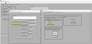

    3. Can you please help me to understand what is the difference between the manual and automatic calibration? Are there limitations of the automatic calibration?
    In the Auto-cal tab, the difference between Manual calibration (clicking 'Start' and 'Continue' a lot of times) and automatic calibration (pressing auto-continue) is that manual allows you to time to change the pressure and temperature in the calibration routine - these are guided by the dialogue box at the top of the screen, here are a couple of examples:
    Once all manual calibration is complete, the user is prompted to write to EEPROM.
    Auto-continue is usually used the sensor emulator that does not require the user to change the pressure or temperature as these are being emulated & aren't an actual pressure sensor in a temperature range. The calibration results are written into the EEPROM, and the program will not stop until "Calibration Complete!"
    I recommend setting up the calibration in "Set up Cal" tab and running the calibration in "Auto-Cal," this is the easiest way to use the device.

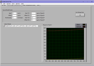

  • Hi Felix,
    The PGA309EVM does read the sensor min and max in order to determine the correct gain options to calibrate the desired output. The PGA309EVM does not characterize the sensor for the customer.
    Instead, the customer will have ideally already measured their sensor and/or has the sensor's datasheet. From there a sensor emulator model may be created from the "Set up Cal" file, below is an example off of a sensor's datasheet:
    Once the sensor has been emulated correctly, in the Auto-cal tab, the PGA309EVM will run through the calibration routine to determine from sensor measurements what internal registers must be set to provide the expected output voltage.
    All the best,
    Carolina

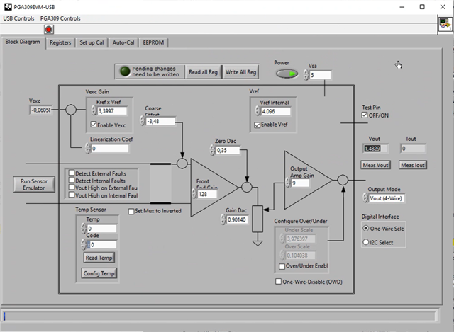

    Attached you can find a setting our customer had done.
    If we would had for example 2mV offset we would set the coarse offset to -3.48mV which would result in -1.48mV.
    This is value is then multiplied with the gain of 128. The output then is still positive. Can you please help us to understand if there is a calculation for the output of the first OPA?
    From your point of view, what would be the best way to compensate an ofset value which is in between the steps of the coarse value? Would the Set up cal functionality solve this?
    Best regards
    Felix

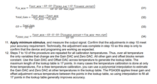

  • Hi Felix,
    The calibration routine will automatically solve this for the customer. The calibration procedure is outlined in Section 5.4 of the User's Guide.
    The coarse offset isn't calculated until Step 7, please have the customer follow these steps if they would like to calculate coarse offset - however my recommendation is to just connect the EVM and run through a calibration routine instead.
    All the best,
    Carolina

  • Hi Felix,
    Here is the user's guide I am referring to: PGA309 User's Guide (Rev. C)
    The calibration routine the program automatically runs through is outlined on Page 106:
    All the best,
    Carolina
